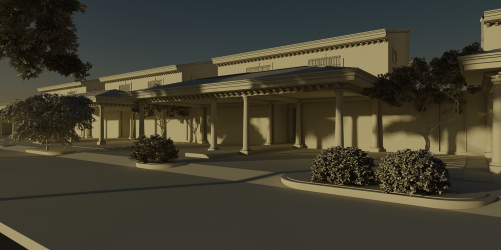

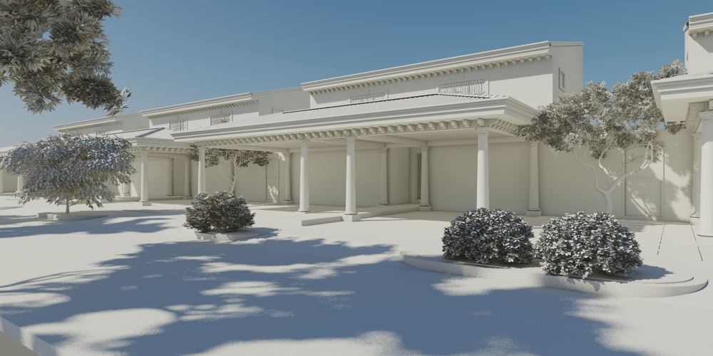

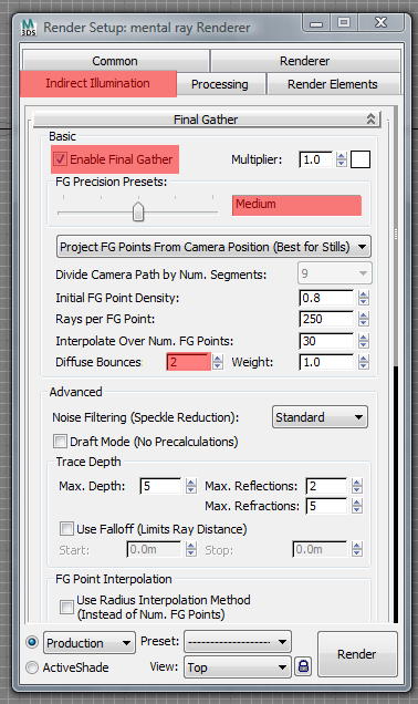

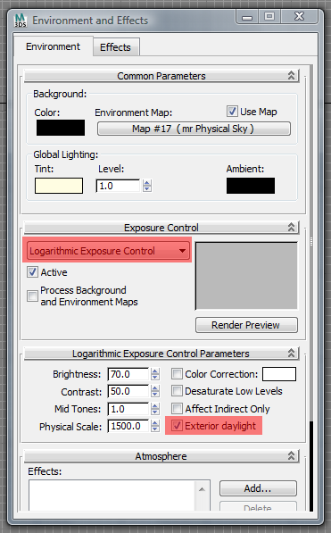

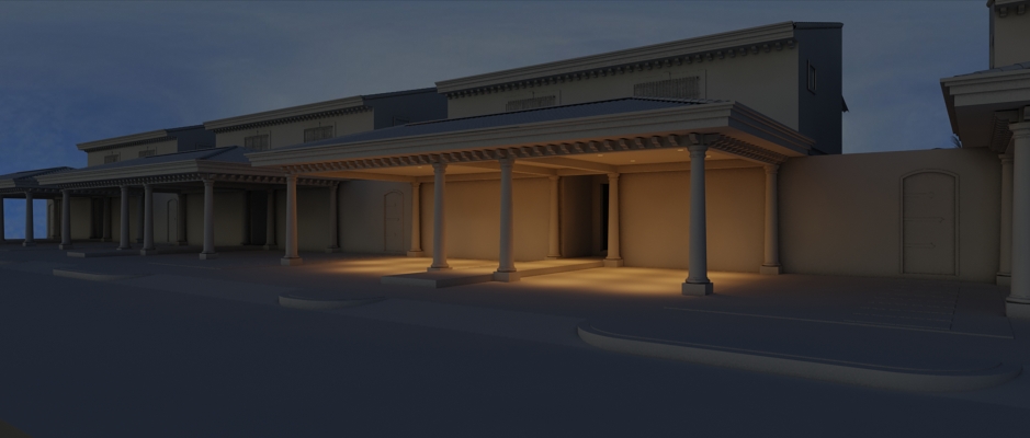

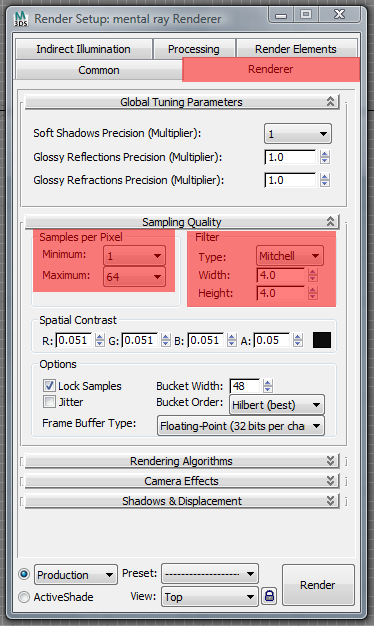

Hi Agatha, try with these settings.
Note:  The materials of this model were set to be rendered in white but it's an .fbx (imported file). 3ds Max Design 2011.
Edited on: Thu, Apr 29, 2010 at 9:32:35 PM

Ernesto,
I am just curious why you use Logarithmic Exposure Control rather than the Mental Ray Photographic?

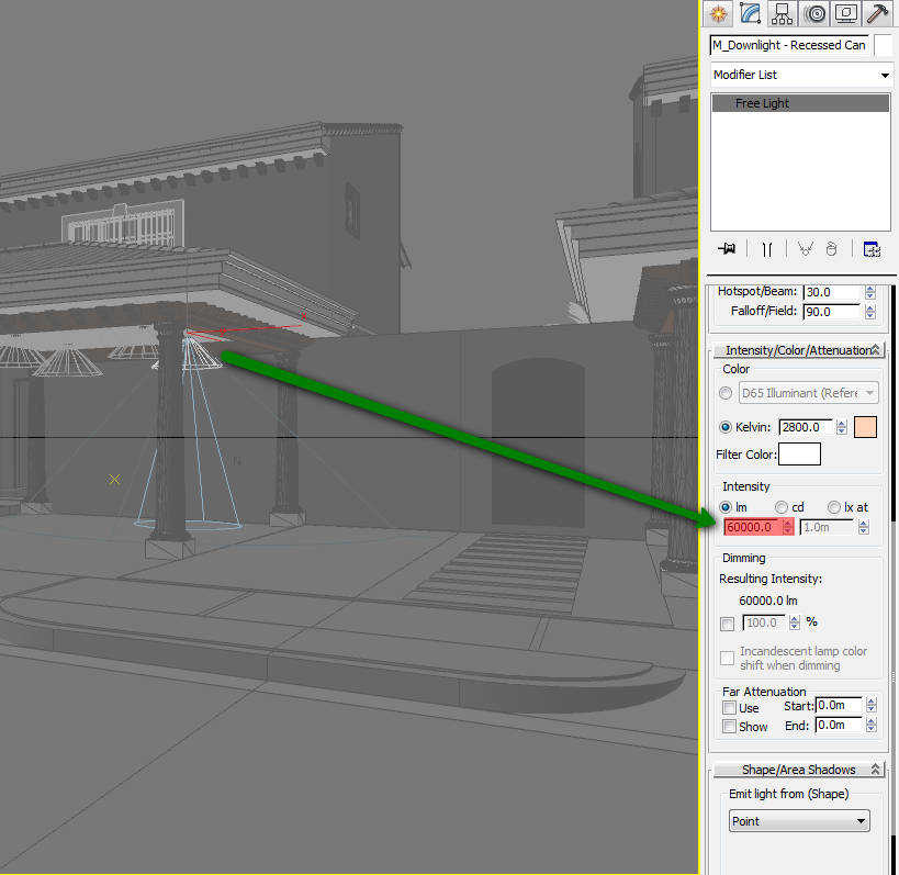

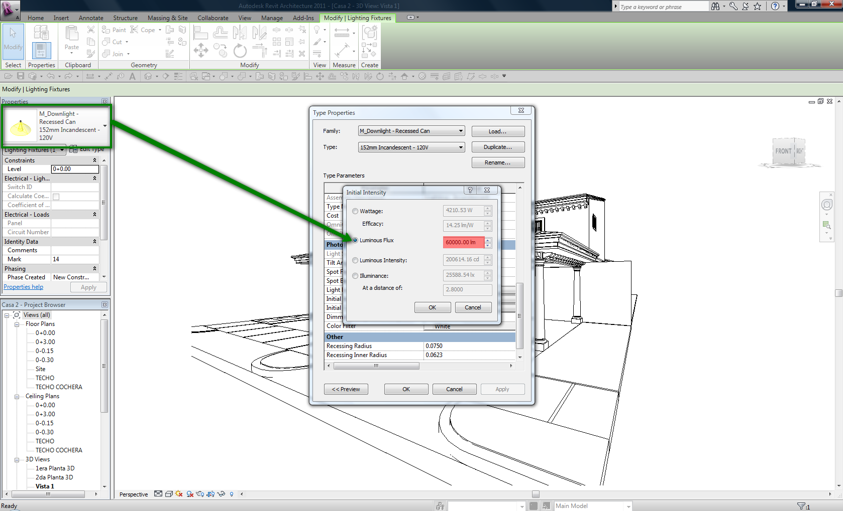

Agatha, before you export your model to 3ds Max via .fbx, change the initial intensity of your lightning fixtures (luminous flux - Revit works with Watts, Max with Lumens).....see the images....

Alabaster - yes, I use mr Photographic Exposure Control for my still images but I thought since Agatha has just started using 3ds Max., Logaritmic Exposure Control (which is used for animations), has less settings than Photographic exp. control.....
