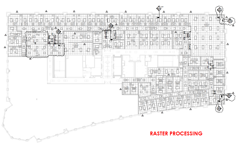

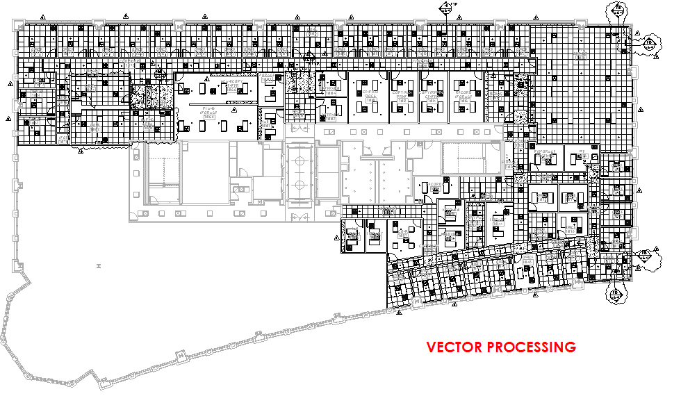

OK I have a real head scratcher.
I am working in Revit Arch 2010. Using Windows XP, 64bit. I have all service packs loaded and am up to date on any patches.
I want to print all my sheets using Vector Processing as the lines come out cleaner. I am printing to PDF. This works great for all but one sheet. I have two RCPs, the 2nd level prints out fine, but when I do the 3rd level half of the ceilings disappear! If I use Raster Processing the ceilings are all there, but it's not as clean looking as Vector.
I have selected all the ceilings there is no difference whatsoever. It's not adobe as when I do a preview I can see there are ceilings missing. But I have tried printing to the printer, and printing as a PLT with the same results. Missing ceilings!!!
I have shut down Revit and restarted the computer. I haven't yet tried it on another computer
Here are screen shots of what is happening. Does anyone have a clue as to why this one sheet is doing this???
Thanks - Diane

I got my co-worker to open the project up and he is having the same problem. But he found if you move any one of the boundary lines off the wall about an inch it will print! WTF! I don't want my boundary to be an inch off a wall, this is not a viable option but WHY WHY WHY is it doing this??
All the walls are the same as well.

It appears to me that when printing with vector processing, objects that are underneath will appear on top if they were created after the object on top.  In other words, the latest object created will be the object showing on top.  This is very frustrating!
Does anyone know how to tell Revit which objects to display on top without copying and pasting a new object?

I should have clarified: when dealing with model objects in a wireframe view, if those objects have surface hatches, whether or not they apear "over" other objects depends on the order in which they were created.
An object with a solid suface hatch will completely mask any other object that was created earlier (in wireframe mode)
