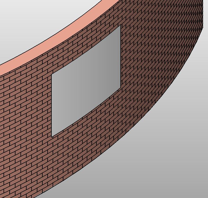

Can it be done, the feature wont let me do it?

You can't "Split" a face in a curved wall, Revit don't allow...

Hi skip9,
 maybe this will help you.
1. Create your primary wall
2. Create your secondary wall with same start and endpoints, but with another material. There you will be notified that there is a wall in the same place.
3. Change the start and endpoint of the secondary wall, and if desired the ofset of the ground and ceiling.
And voila... you can "split" a curved wall and assign different materials.
Greetings
Volkmar
Sat, May 1, 2010 at 6:14:22 AM | "Split Face" on Curved/Arc Wall?
carlos08
Joined: Wed, Feb 8, 2006
3 Posts
Hi skip9,
forgot to mention that you have to cut the geometrie..
using split face tool on curved walls
