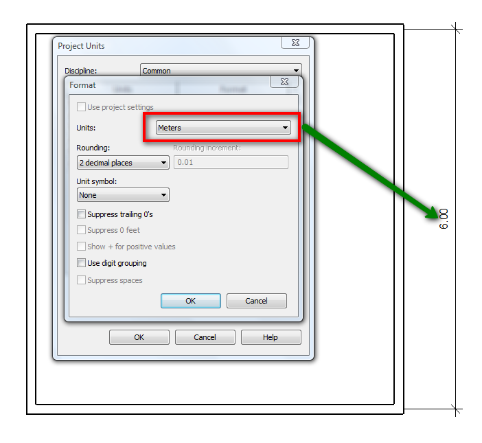

is there an easy way to convert a .rta file from imperial  to metric ?

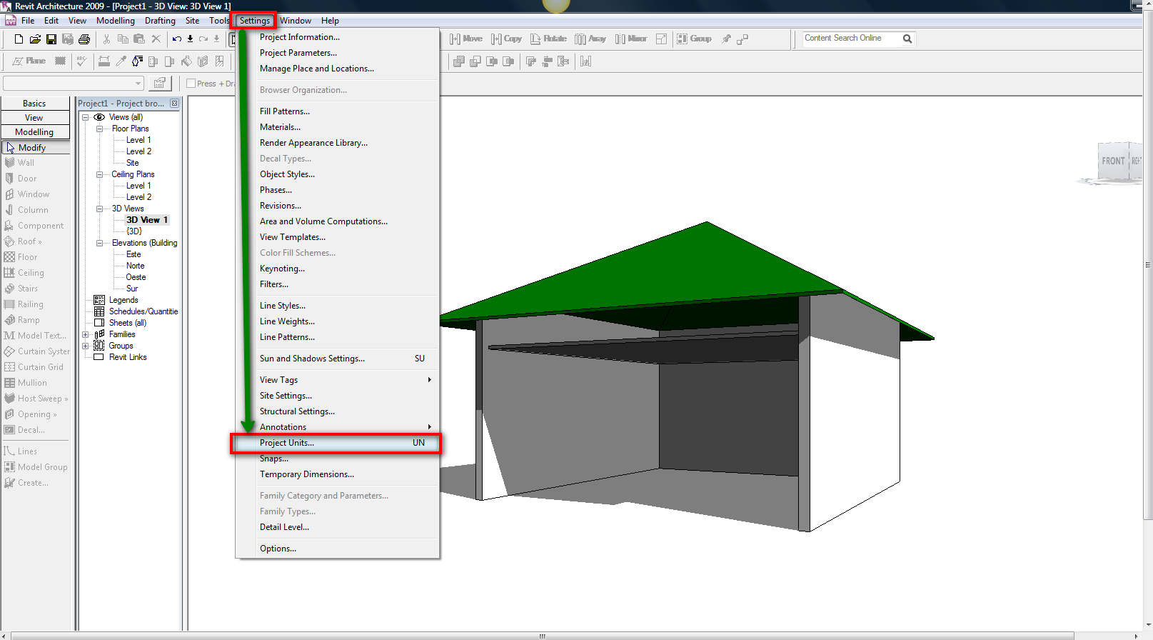

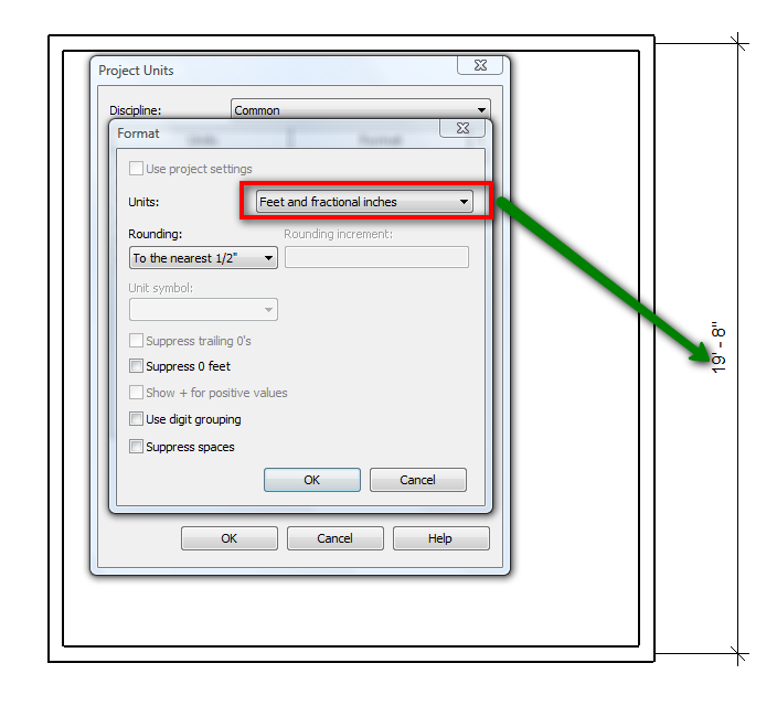

Settings-->Project Units...( or type UN), and change the units from feet and fractional inches to meter......
showing metric and imperial elevations
