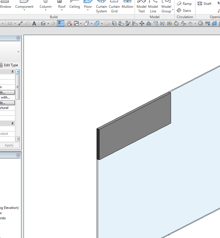

I was wondering if it is possible to split the face of a curtain wall and paint it. I think this would be a way that I could acheive the look of a patterned frit. It seems to not let me select the curtain wall though when I go to split the face.

You CAN'T split a face of a curtain wall, but you can create solid panels.
