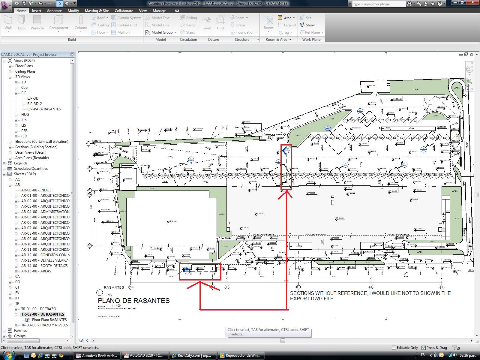

im having a problem when i export to dwg. because revit export the views that are not referenced, the ones are not in any sheet.. what could i do to avoid this?

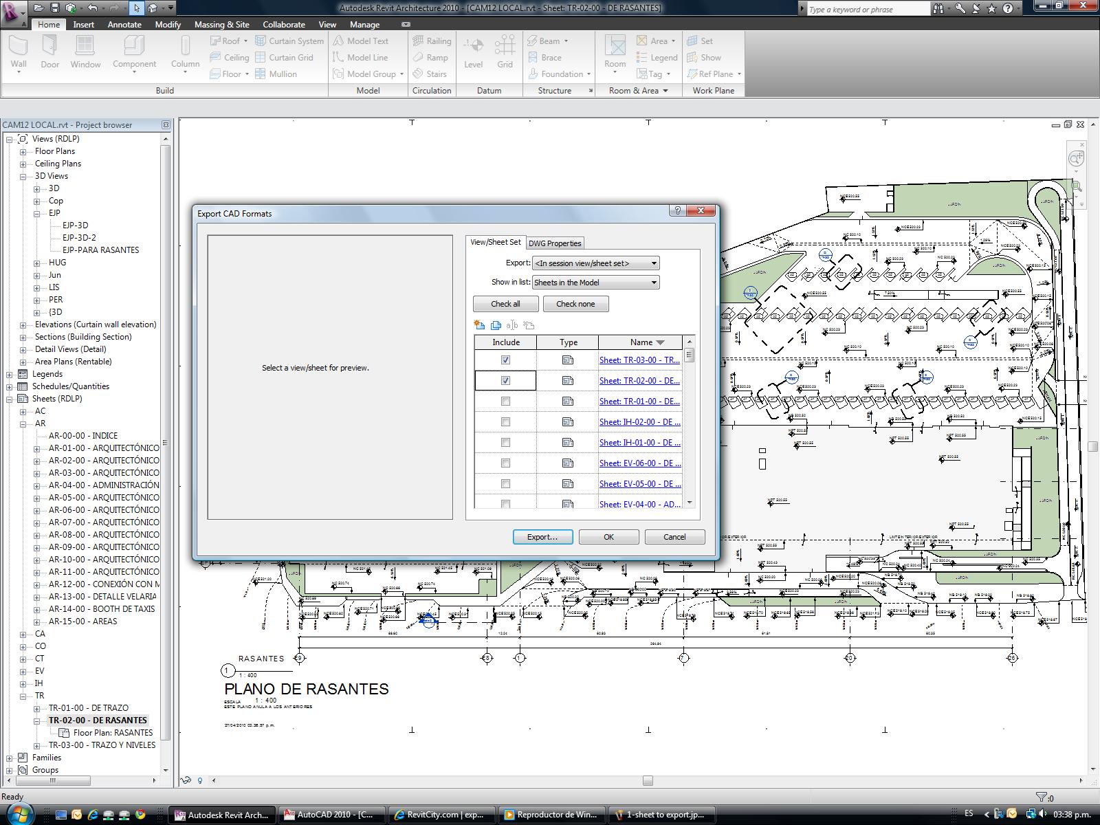

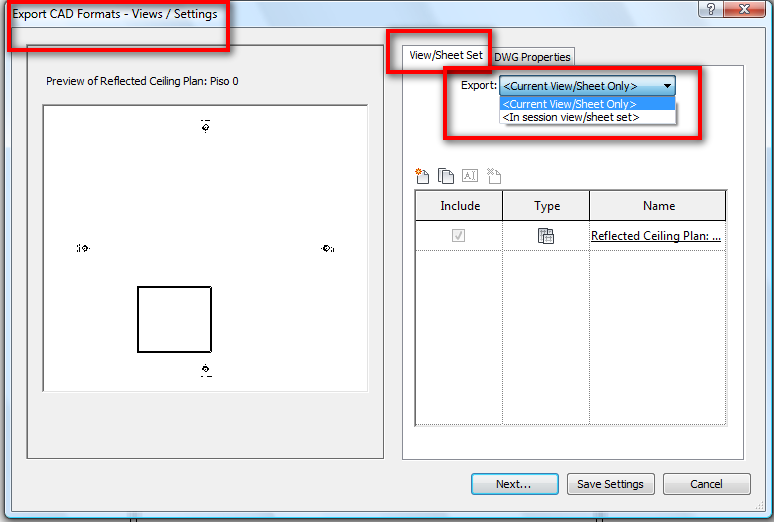

How did you export?

i export like the image you attached...
in revit i have some views i dont need in sheets, but i work in them...so, when i print from revit, there´s no  problem because this veiw tags doesnt appear in the print...but when i export...they appear in mi dwg file...thats a problem because i use my export dwg, for my clients...but they print directly from this file...so i need to configure my export properties to export correctly...do you know how should i do to avoid this veiw tags without reference? i cant delete the views from revit cause i use them to work...
 i attache some image to explain what i do, and whats the problem

click on them and use the glasses to hide element, then apply hidden.
And unhide them when you need them
