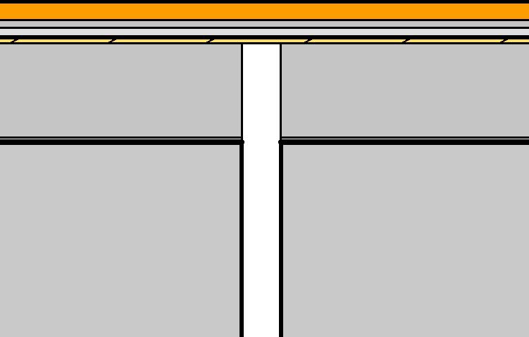

Please se attached image.
This is a section-view where we can see my roof on the top and a non-bearing 120mm wall that's attached to it.
 I want the wall to go up to the roof, but i don't want it to penetrate any layers.
 I've just started to learn about the different layers of a wall etc, and when a multi-layer wall is meeting the roof i've been able to handle it by leaving one layer (the isolation) continue up to the roof, but with a wall like this with just one layer I don't really know what way to go.
 I can't add a 0 thickness layer, as that would be a membrane layer and you can't have them within the core boundary by themself.
 So anyone got a tip? Kindest regards

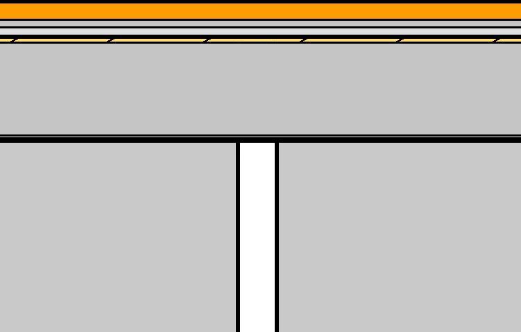

Wed, Apr 28, 2010 at 2:39:50 AM | How to control a single-layer wall?
bengtm
Joined: Mon, Mar 8, 2010
37 Posts
3 Stars: 2 Votes
I've attached two pictures that should show what i want to do.
With the first thing i wrote, i mean this. When attaching the wall to the roof it goes right through one layer and ends up one/two layers too high. When using the attach option I can only choose the roof, not specifically if I want to attach to the bottom or top.
About the other thing I wrote, no I'm not 100% in all the locking parts, I've quite recently started using this program. But what I meant was in "Element Properties" --> "Edit Type" --> "Edit" (structure) you can't assign the layers within the core boundary to wrap? Nor will the function/priority be properly working? And that's what I'm wondering if I can do. Because if I could have this one layer outside the core boundary being able to wrap it, my problem would be solved.
The last thing I wrote is the same, the fact that only when i have two or more layers in the wall, I can put one outside of the Core Boundary to get it to respond to the layer functioning. It seems as if the layers within the core boundary isn't as responsive to layer function priority as the ones outside.
I'm sorry if it's a bit messy, but I hope that this will clearify a bit.
