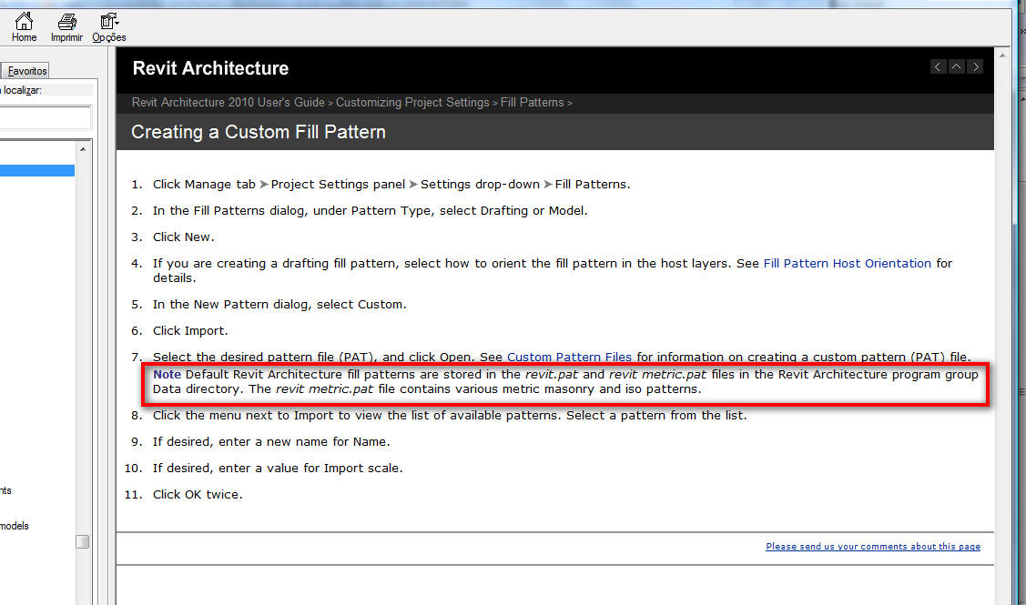

I am attempting to create a detail component of steel decking that already has concrete built in on top; unfortunately concrete is not a default option for the fill patterns for regions so I'm having to create a new one and define it manually.  The problem is that I cannot find the folder with all of the revit 2010 pattern (.pat) files.
Could somebody -please- direct me to this folder.  Thank you.

It doesn't seem to be there either.  I know it's here somewhere '-_-

Directly from the HELP menu...
Tue, Apr 27, 2010 at 9:21:43 AM | Where is the 2010 Patterns Folder?
Mine is in C:\Program Files\Autodesk Revit Architecture 2010\Data\Revit.pat
All the pattern files are in that one file.

And mine is in d:\Program Files\Autodesk Revit Architecture 2010\Data\Revit Metric.pat

Ah, I was hunting for an individual concrete.pat file.  '-_-

The revit.pat had what I was looking for, but thanks for the link.  It'll be good to know once I start making my own patterns.

We would have gotten here a whole lot quicker if you had said you were looking for one file.  The conc.pat is part of the complete pat file.  It can be loaded at different scales if you want to do that.  It can also be isolated to it's own file - just delete everything else and save the file as conc.pat.
