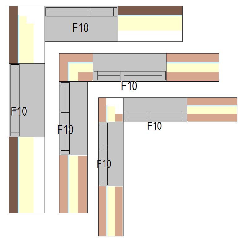

Hey, I'm having a problem that I don't really know how to solve.
 Please watch the attached picture!
 The problem is that when I attach two windows to the corner (or one window at the upper wall) you can see that the wall just goes straight out into nowhere instead of "closing in" Compare how the wall in the corner behaves in the left and right pictures compared to the middle one.
 The weird thing is that on the middle picture I've attached the window to the corner on the vertical wall, and there's no problem, but if I do the same thing on the horisontal wall, the vertical wall will just go out into nowhere.
 It's a problem that can be solved by moving the window 1 millimeter away from the corner, but I don't see that as a legitimate fix.
 Anyone else experienced this and know about a fix?
Kindest regards.

Try this sequence - may not need #1
  1. Set location line to exterior
  2. pull one window back from the corner
  3. edit the wall join using the miter setting
  4. Put the window back

Solution worked perfectly, thank you very much!
