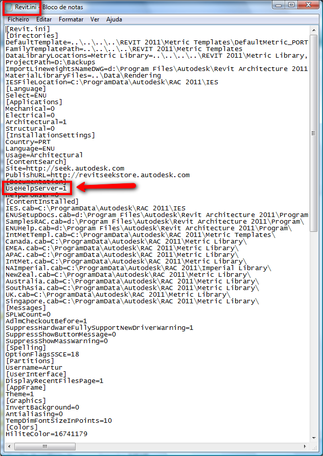

I didn't try this yet but in your Revit.ini, change the "UseHelpServer=1" to "UseHelpServer=0"
