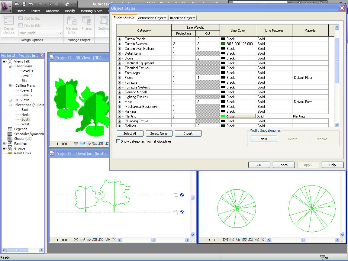

Im wondering if it is possible to change the color of the 2d image that RPC trees show up as in elevations and 3d views.  I want to reperesent the color of the tree as green instead of the standard RPC grey.  I know that i could probably throw it into photoshop and edit the trees that way, but that is the long way if is possible to change the color in revit.   Any help would be appreciated.

Go to Settings menu>>Object Styles. Under Model Objects Tab select Planting and change the color for plan and elevation, for 3D color create one material and apply here as shown in the attached image.

OH! Thats right!  Thanks alot. I should have known that.
