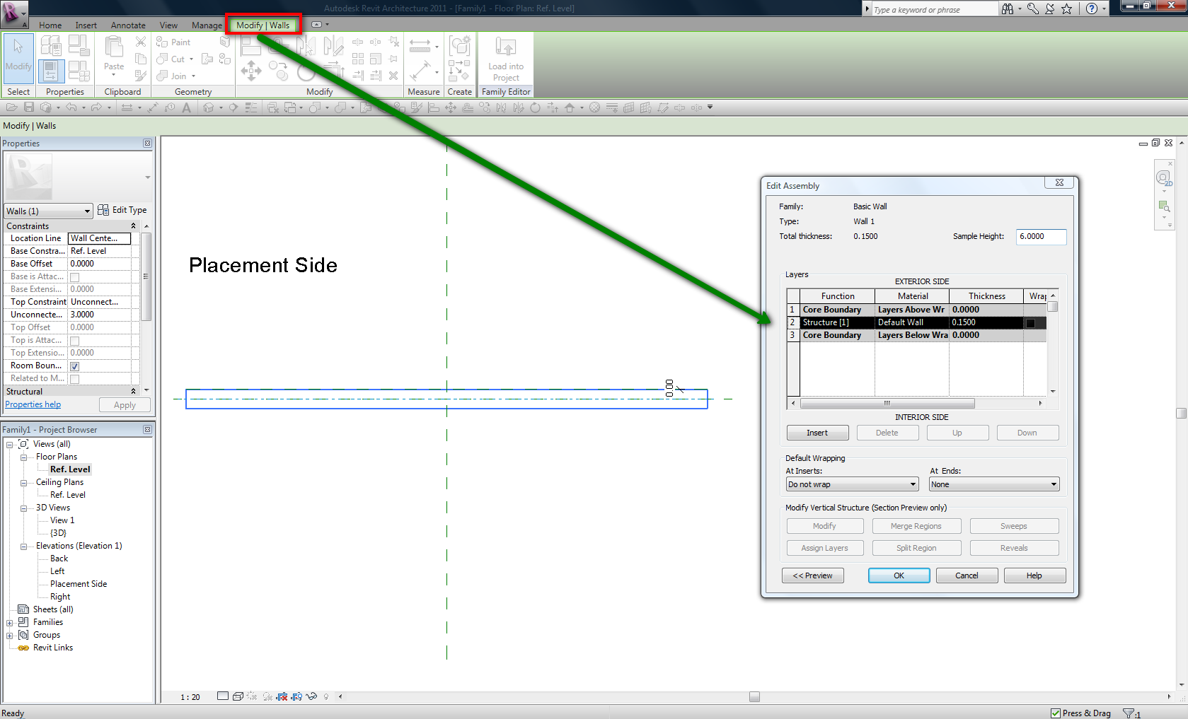

There's no wall templates in the library. Walls are instances of predefined system family types. I think, what you are looking for is to create a Generic Model Wall Based-family. There you will be able to made the family you want with the specifics of the walls you need......
Thu, Apr 22, 2010 at 7:30:28 AM | help with wall families
erland - I think he just needs to define new wall types.
The Families Guide contains conceptual explanations, procedures, and reference information.
To access the Revit Architecture Families Guide, click  (Help) drop-down and Families Guide.
