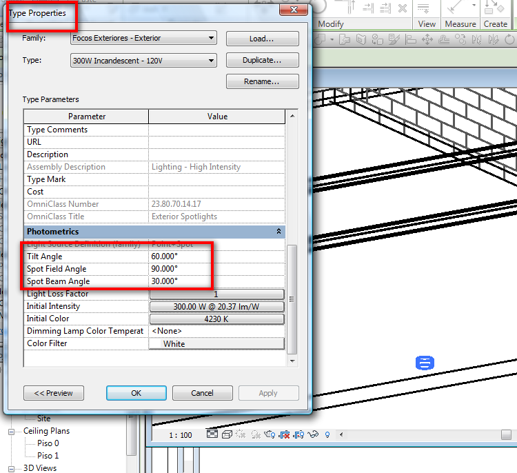

You must insert the right light (wall, floor) then in the properties of that light check the "Tilt Angle, Spot field angle and Spot beam angle" like you can see in the image....
