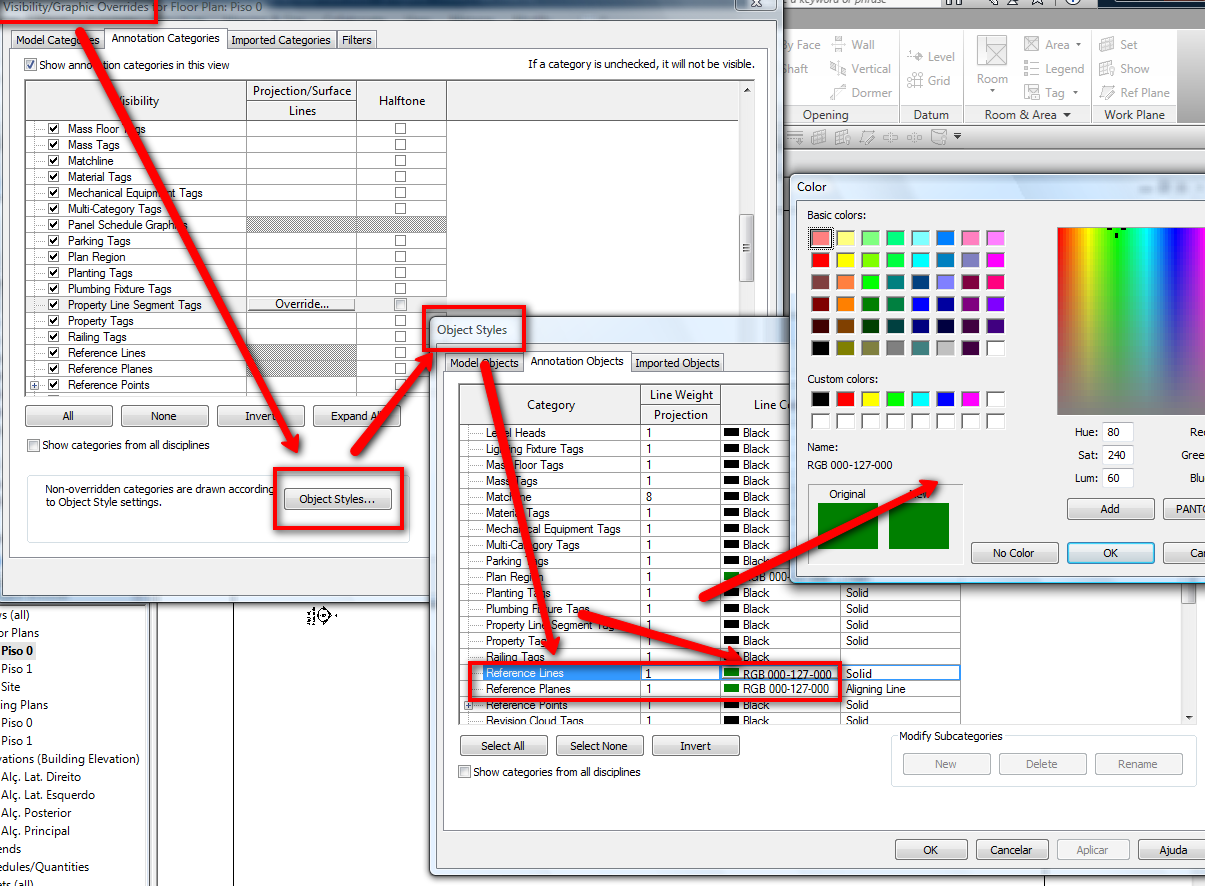

Hi,
Is that possible to assign different color for the reference line in Revit?Or besides to name the reference line, is there any other way to help distinguish different reference line?
Thanks,

In the VG>Object styles you can change the color of your Ref. Lines like you can see in the image....
