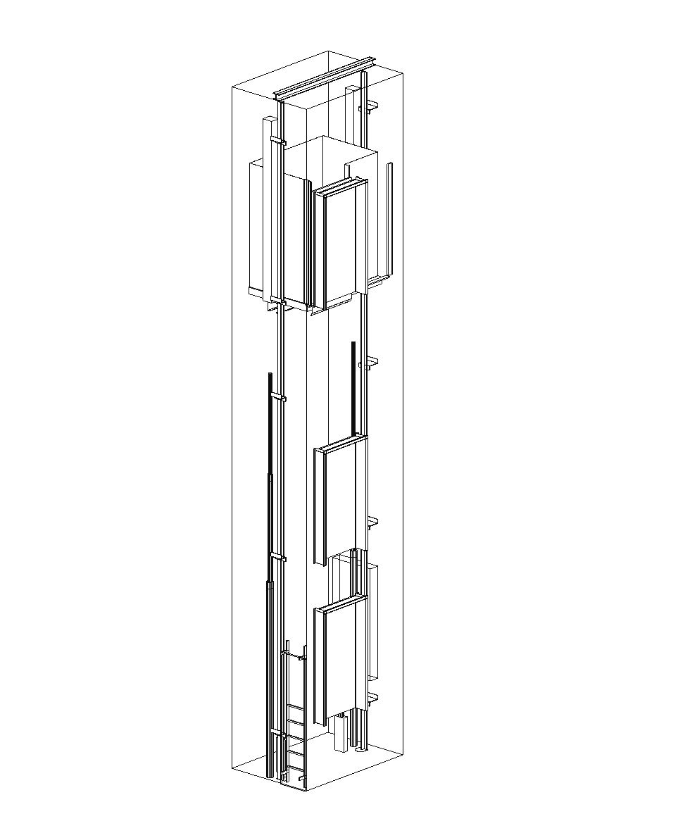

Here's a snippet of what the Otis add-in can create.  I didn't need it here, but i'm pretty sure in the options when you create it you can have doors on opposite/alternate sides.  Model comes in pretty detailed, and includes a lot of useful detail for additional space needed for the pit, location of controls, etc...
