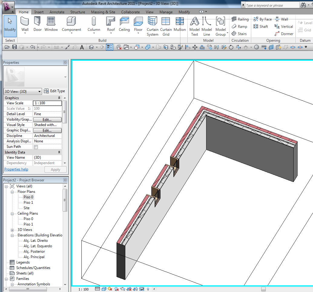

Hi
Looking for some advice if possible.
Please see attached PDF. I am trying to get the wall join on the corner to clean up / join correctly. It is fine in plan view but just wont seem to work correctly i a 3D cutaway view
Any ideas anyone??
Thanks

can we see it in plan also?

They are the same type of walls?, the same material name?

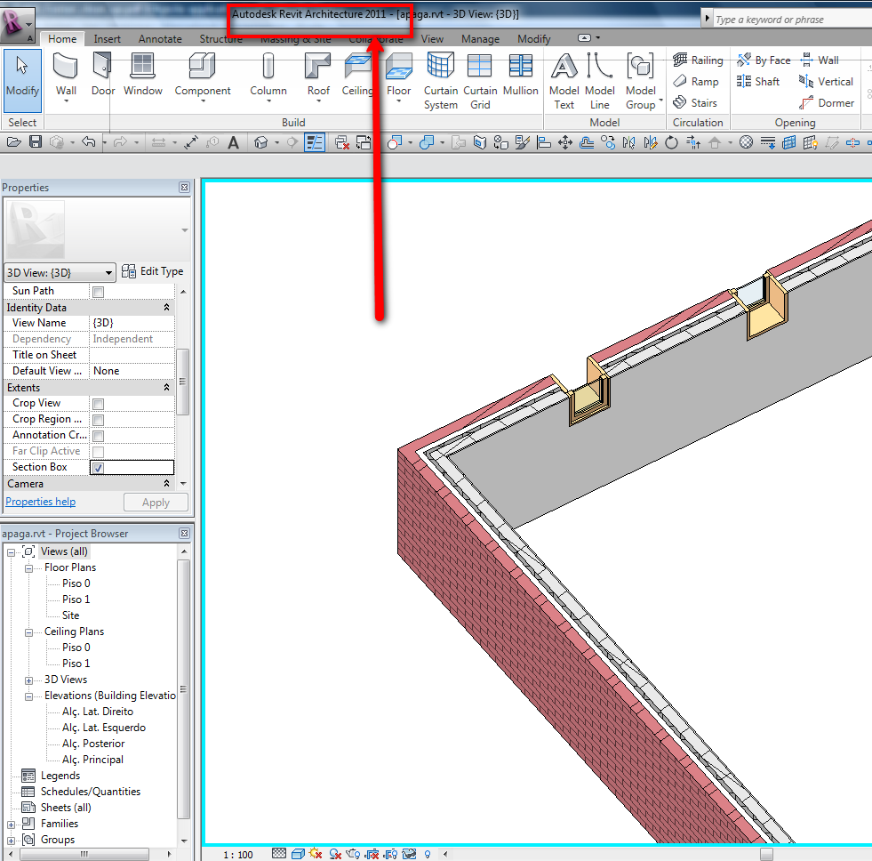

Hi
Plan view attached as requested. Yes they are both the same wall type. The project was started in revit 2010 where i had the problem. I am now using 2011

Wierd... i did the same process, start in 2010, save the file, open in 2011 and it's ok... can you put here only those 2 walls so we can check...
Tue, Apr 20, 2010 at 7:50:06 AM | Wall clean up in 3D View
Are these stacked walls?
Did you edit the profile of any of the walls?

Thanks for help everyone but think i have sorted it. In the 3D view i edited the join to mitre and it worked, i would of thought that doing this in plan would also update any cutaway view but it must not.
I still cant fix the corners of the front projection but i think that may be because i have edited the wall profile higher up to step out and form eaves
Tue, Apr 20, 2010 at 8:32:41 AM | Wall clean up in 3D View
A few pointers you may not know:
  1. You can always unstack a astacked wall after it is places.  This helps with some cleanup issues.
  2. As you have found - wall profile edits can affect clean-ups.
  3. For bump out areas at eaves like you have, I like to split my wall horizontally at the bump-out.  The upper portion can be attached to the roof and the lower portion will then cleanup correctly.  Use the join tool to remove the horizontal line between the two walls.
