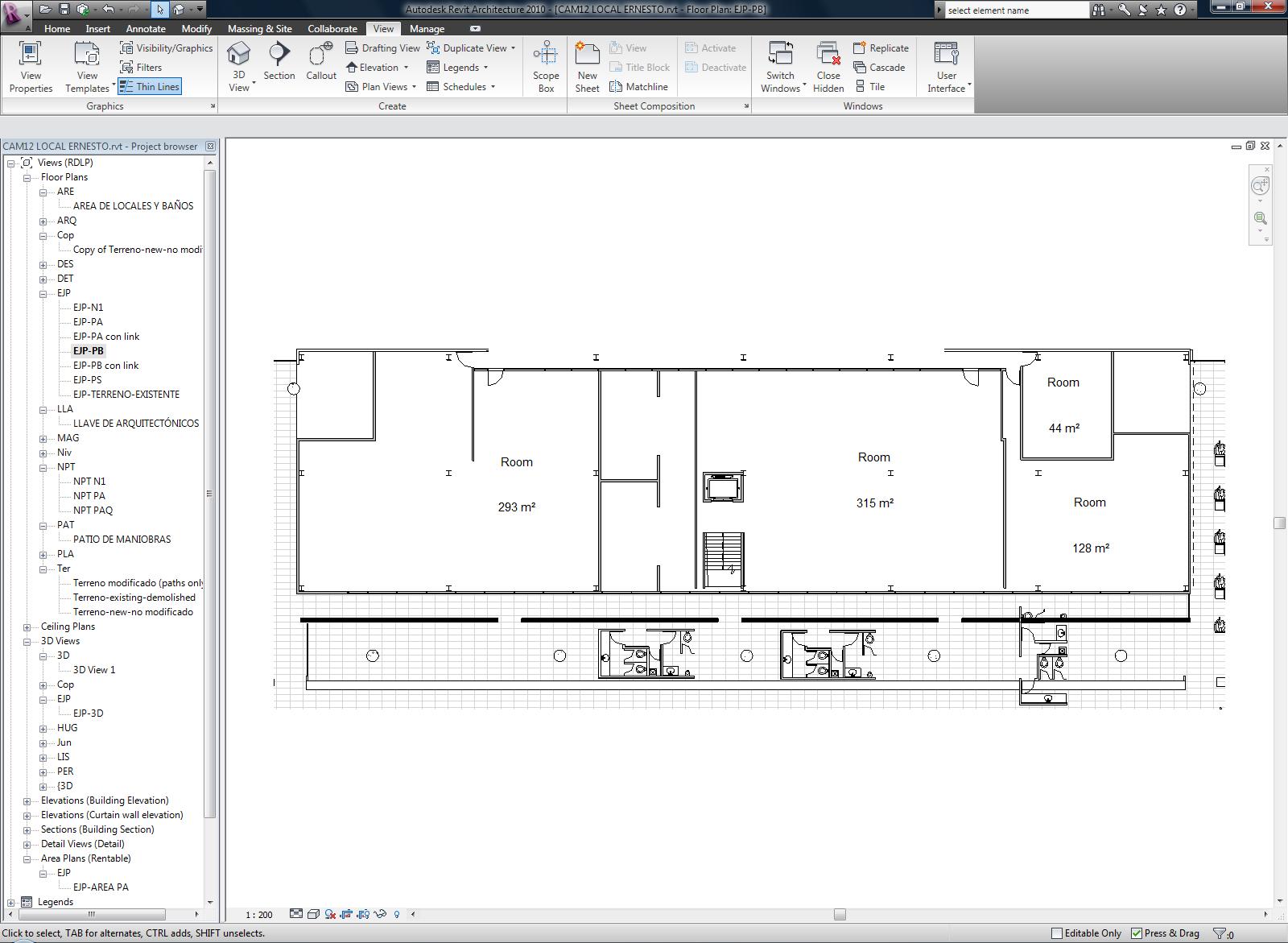

 hi, i have a floor plan where i wwant to show some areas. so i put a room area tag, thats ok and i have four room areas...
i need besides to show the m2 of these 4 rooms...how can i do this?}
i attached an image of the floor plan...hope i was explicit

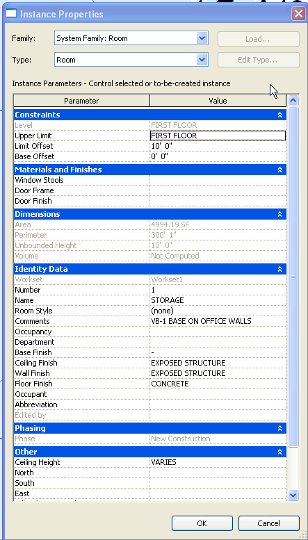

You can always use sub-groupings and total those areas.  For instance, you could use the department settings for rooms - assign multiple rooms to a department, sort by the departments and areas by departments.

could you help to do that? where can i find this option tu make sub-groupings? or should i make an area plan?
Mon, Apr 19, 2010 at 1:45:30 PM | rooma area of several room areas
Look in your roop properties, there are already parameters there that you could use... or you could always add a project parameter.  You can rfead about parameters and schedules in your HELP
