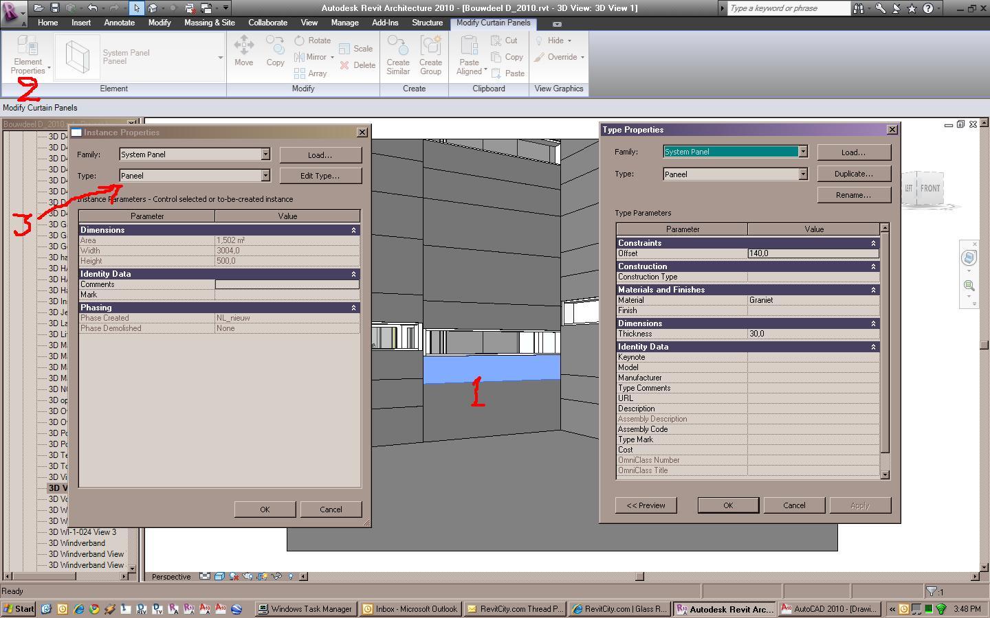

Are you sure you have checed the properties of the panel?
Are you sure it is glas or is it a solid panel?
Does it show transparent in a 3D view?
As you can see in the image it is possible to have both sollid and transparent panels in the same curtain wall.
1 select the panel
2 check in the elementproperties if you have set it to glazed.
3 when you don't have a glazed panel create one;
edit type -> duplicate -> select the desired glass in material.
