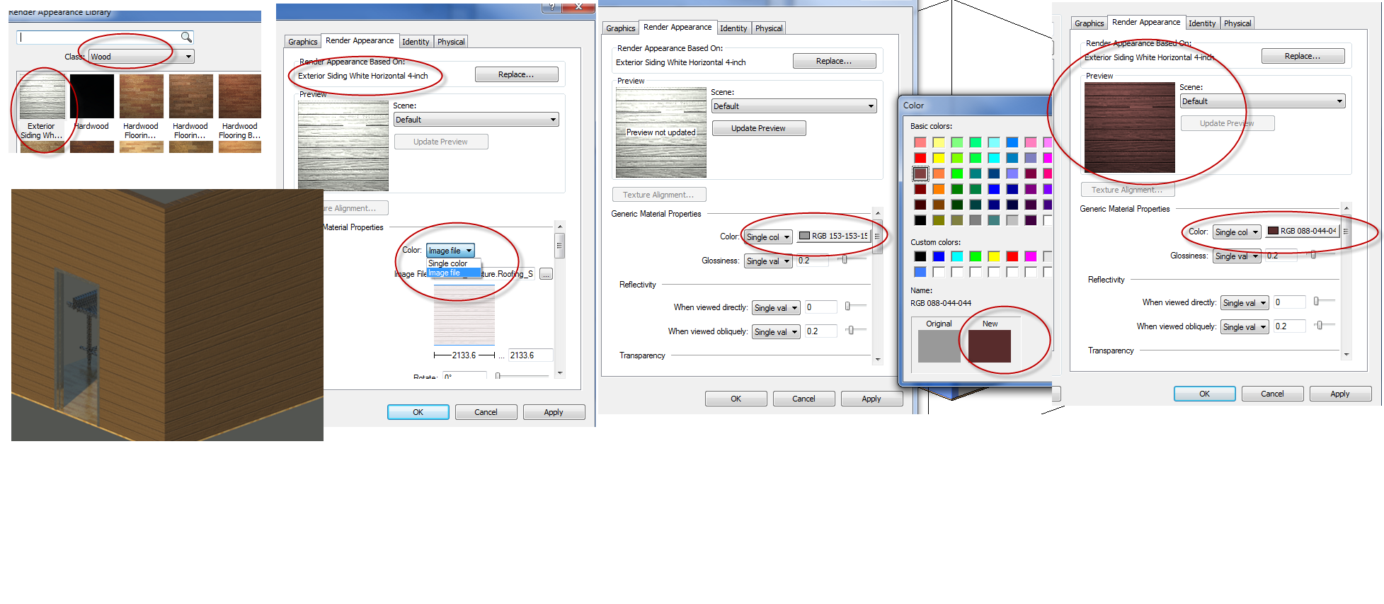

Was wondering how do you create patterns in your renders? my building has wooden cladding, i can render the outer surface so that it is wooden, was wondering is ther a way to put lines across the wood so that id makes it look like there is wooden panels?

the simplest and easy method would be to replace the associated material raster file with one that has has the characteristics you want.

Here's one way
Add colour to an existing taxture
