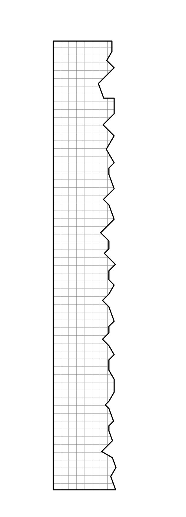

I am detailing spray foam insulation and need a detail component that is adjustable--definitely for length and ideally for width--though not necessary.  I've toyed with the idea of visibility parameters and repeating components but that limits it to fixed predetermined lengths, when I would much prefer something that stretches on an instance basis.  The jagged edge doesnt necessarily need to be quite so...jagged, so in other words if creating a repeating pattern is the solution then that would be acceptable--I just don't want the pattern to have to dictate the length of the component.
  Any ideas/advice?  Thanks!
Fri, Apr 16, 2010 at 12:16:02 PM | Need to make adjustable detail component for spray on insulation--see image
You might ry a repeating detail where the rough face starts and ends in the same vertical plane and that has invisible lines top and bottom.  You could assign a depth (type) parameter and have multiple types.

Just did that, and used "Maximum Spacing" for the layout parameter, so it adjusts to whatever I want.  Thanks!
