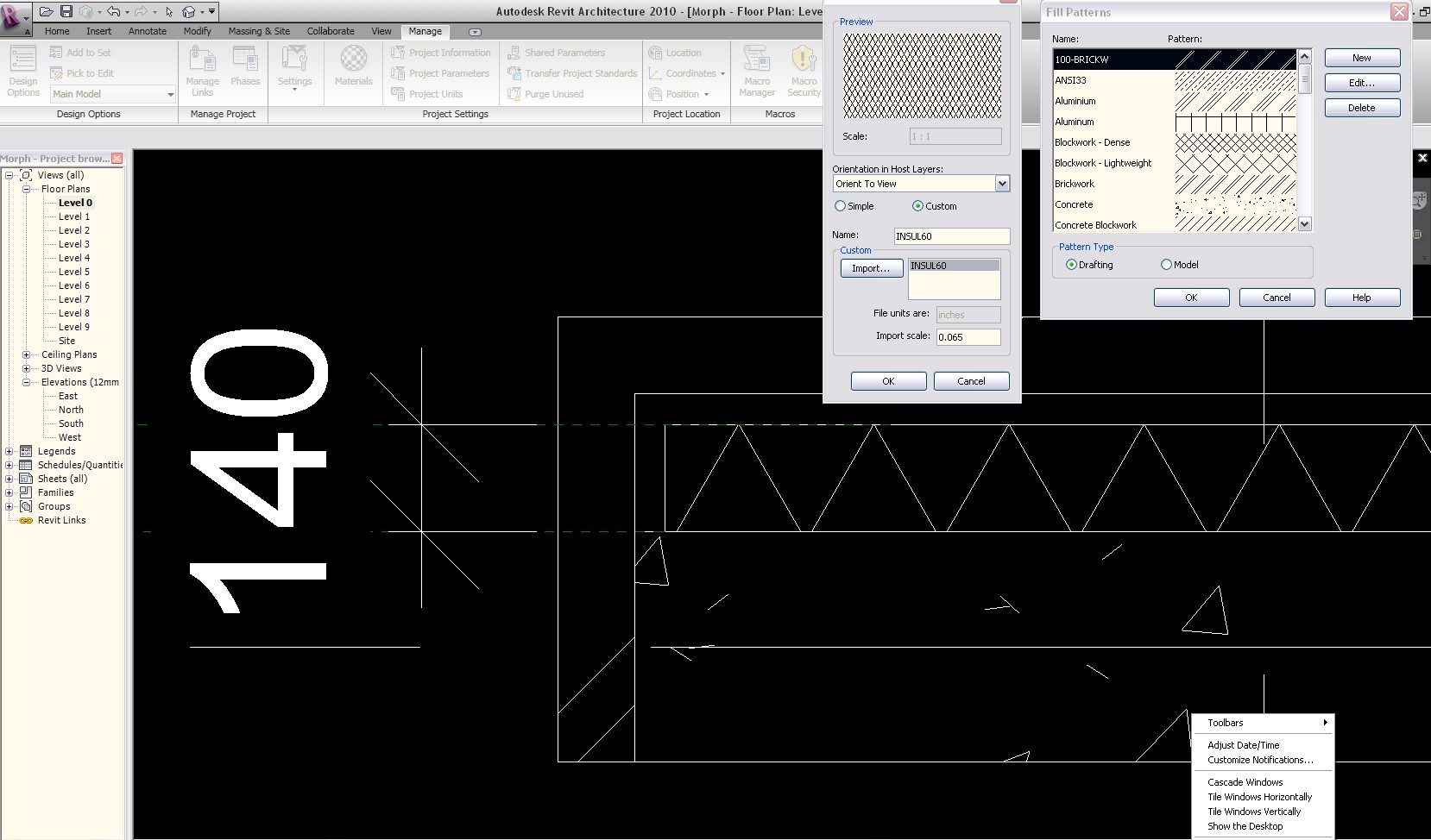

Hi,

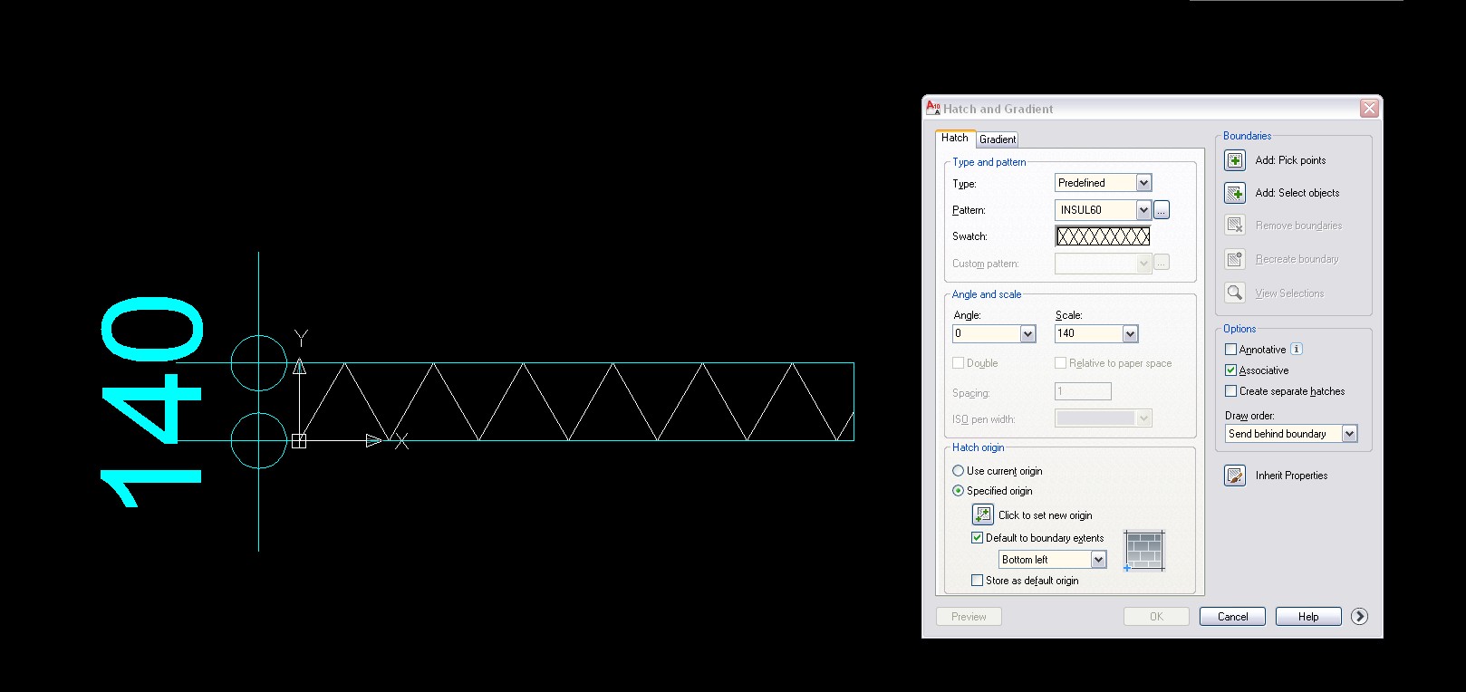

I want to fill the insulation hatch pattern for wall in Revit, Bascially I would like to achieve the effect in Autocad. See the attachment of my hatch pattern, also my Revit and Auotcad setting.
Follows are the problem I met in revit
1.The hatch can not align with the wall line.(like the specified origin in Autocad)
2.The scale I use right now is a strange number, but that give me the closest result.(but still not prefect yet)
Is there any one can help ? Thanks

"1.The hatch can not align with the wall line.(like the specified origin in Autocad)" - You can't "Align" a drafting Hatch, only MODEL....

Typhoon has told you correctly but in addition to this, you do have some settings for drafting patterns that will help you in some situations.  Goto your manage / settings / fill patterns and pick any drafting pattern and choose edit. There you will see a setting "Orientation to host layers".  Under that drop down you will find three settings:
  1. Orient to view
  2. Keep readable
  3. Align with element
You will find that for wall cut hatches (and some other situations), you will want those patters set to Align with element.  NOTE:  This is a global setting.

Thanks for the help!It works in the model!
