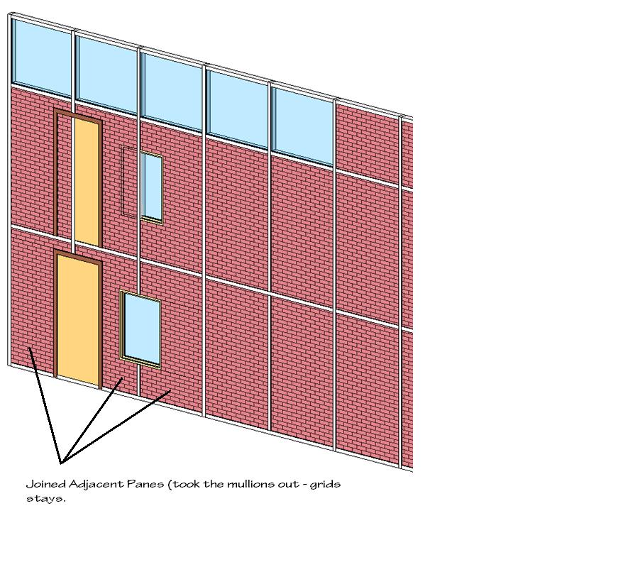

I'm not being offended and I hope your not.  You are missing the point of my post!  A door or window can not  span across a grid line!  You have to edit the grids.  Please look at the attached and if you can do something different - please post.

I'm not being offended in anyway.... I consider this a "constructive argument" in which a lot of ppl learn a lot from including myself. Anyways... I was able to figure something out about it (see attachment).

So you had to add grid lines on above the door (window) and remove those from other areas and remove the grid from the head down  Seems a little complicated.
Vertical wall sweeps are very easy to place on regular walls.  The problem is that the wall will not schedule as individual elements whereas the curtainwall will.

Yup...that's exactly what i did. I totally agree... it's a little bit of tedious work but it can be done.
