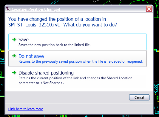

I am working on a large project with 4 to 5 people working on it our office. We have 3 linked files in the project, Structural, MEP, and a site. Everytime I sync with central I get this dialog that pops up. (See Attached) I am the only one in the office who is getting the dialog and no matter witch option i choose it will not go away. Any one seen this before or have any idea what causes it and or how to fix it?

Revit thinks you've done something to move a link (It seems to be touchy about links with shared coordinates). Have you tried closing the project and making a new local?

Ya i ended up closing everyones local file, and then reloading all the links. then having everyone create a new local file. it seems to have fixed the problem for now. it was just weird.
