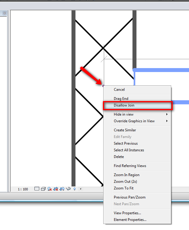

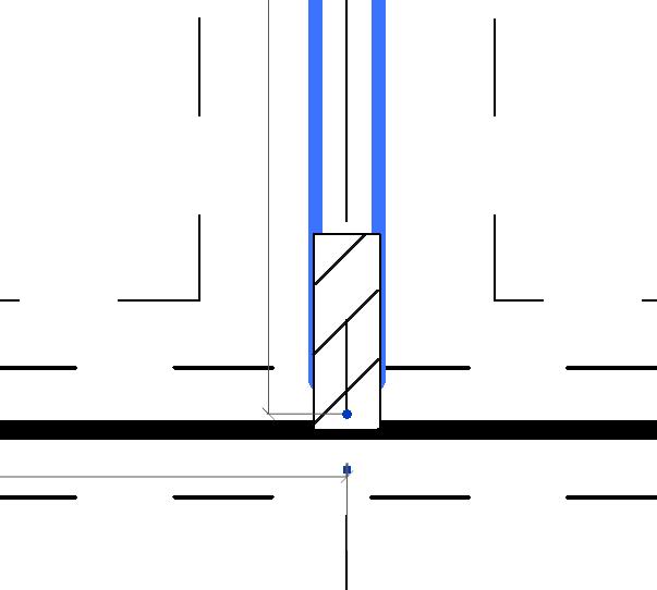

I am working on a project where the wall ends are not extending to the exterior slab edge like I would perfer.  I think it has something to do with a joining issue but I can't figure out how to get the wall extended.  Also, If you drag the wall end beyond the grid the wall extends fine.  Any help would be great.  Thanks.
Fri, Apr 9, 2010 at 1:11:52 PM | Wall Ends No going to Gridlines
Joined: Tue, May 22, 2007
5921 Posts
4 Stars: 205 Votes
Pick in the "Blue DOT" with the right button then choose "Disallow Join", i think this is what you want....

YOU are Awesome!  That has driven me crazy and thanks for your help!

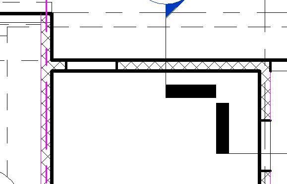

Any ideas why I can't get this line to change from magenta?
Fri, Apr 9, 2010 at 1:54:17 PM | Wall Ends No going to Gridlines
Is this a structural indication of some sort?  Look under settings / object styles (make sure show categories from all disciplines is checked then expand the categories and find out what might be represented by magenta lines....

It does actually move with the wall.   I can select the drag point and move the wall and it moves with the structural wall. i looked at settings and nothing was magenta.  Really odd.
