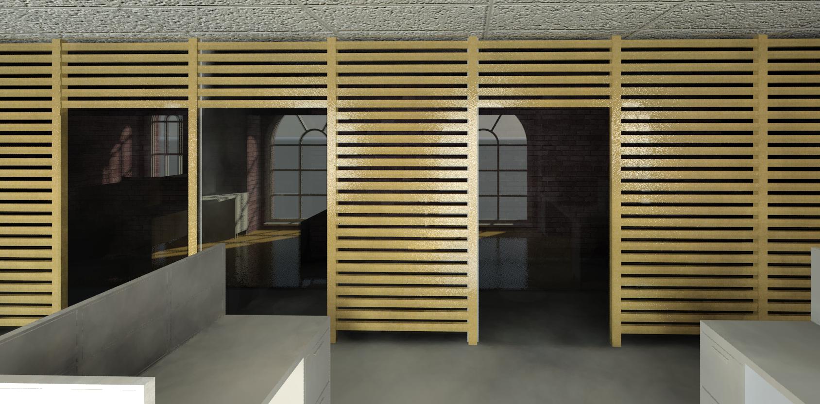

many thanks - with a bit of playing i'm half way there.... enclosed image
Just need to figure out how to make the horizontal mullions closer and add the doors!  Thx for advice!

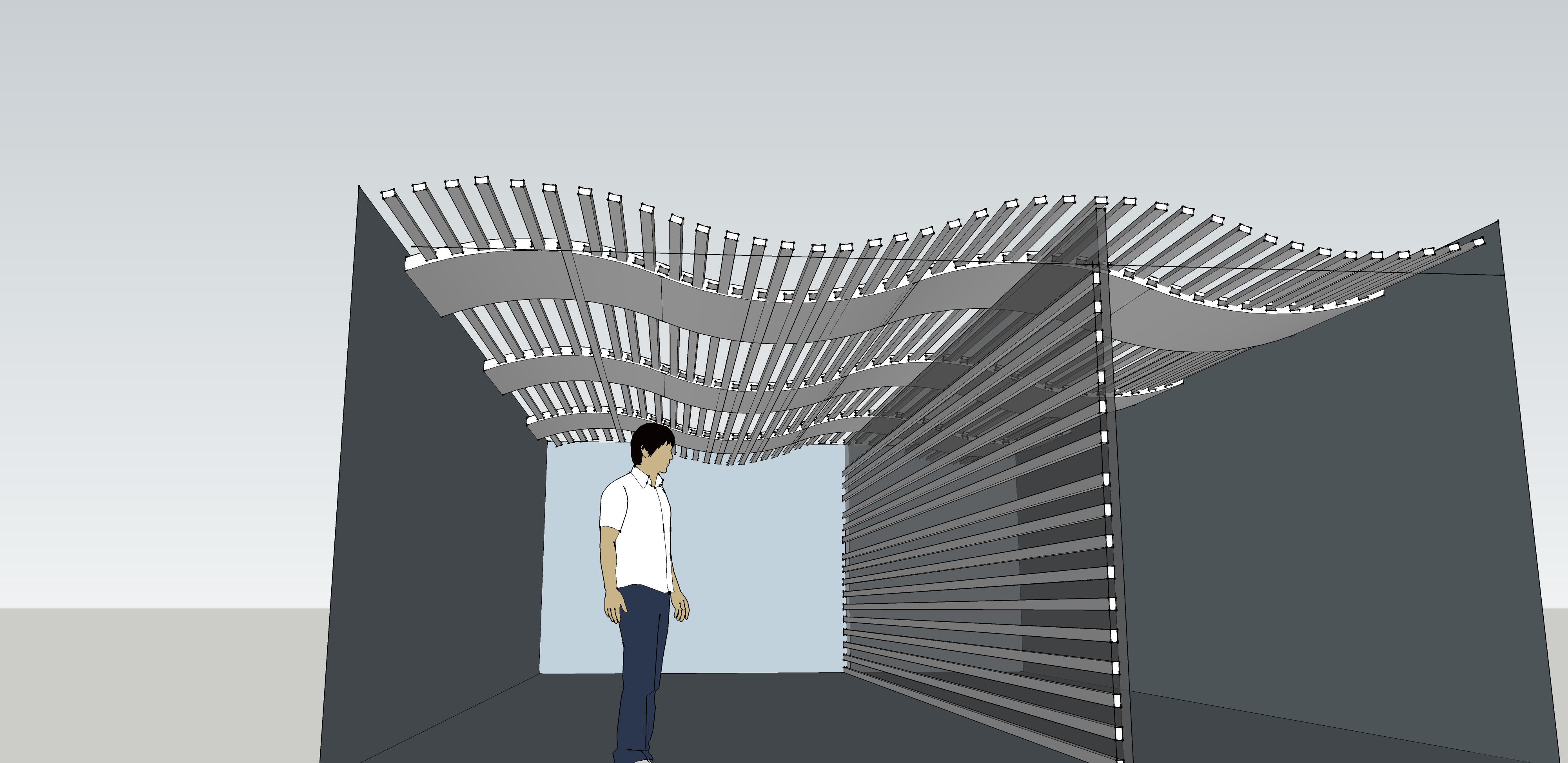

also thx WWHub - i think this will be easier way of handling the outer slats layer.  I'm attempting a similar thing with the ceiling next... I've enclosed a rough sketchup image.  I havent truly looked into this yet, but any advice on how to get started with this one? (sry to add into same thread).

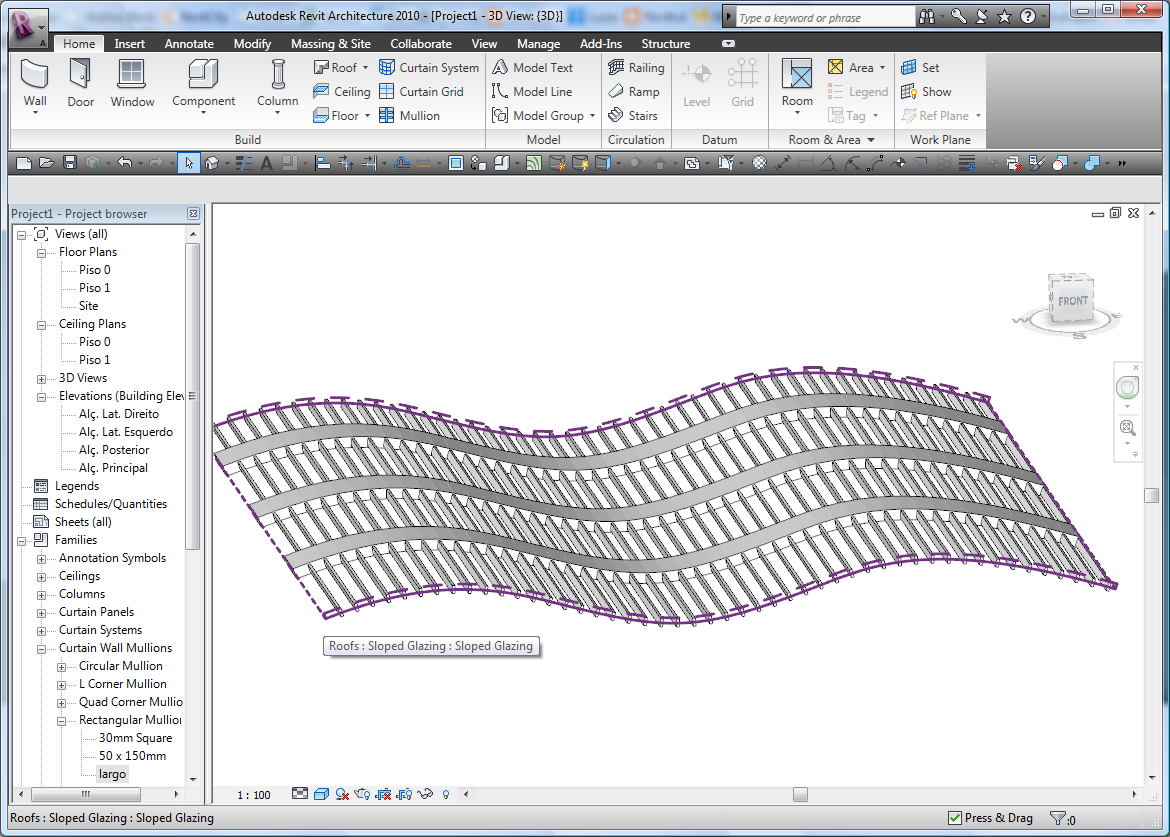

I think i use the "Sloped Glazing" system to create that...
