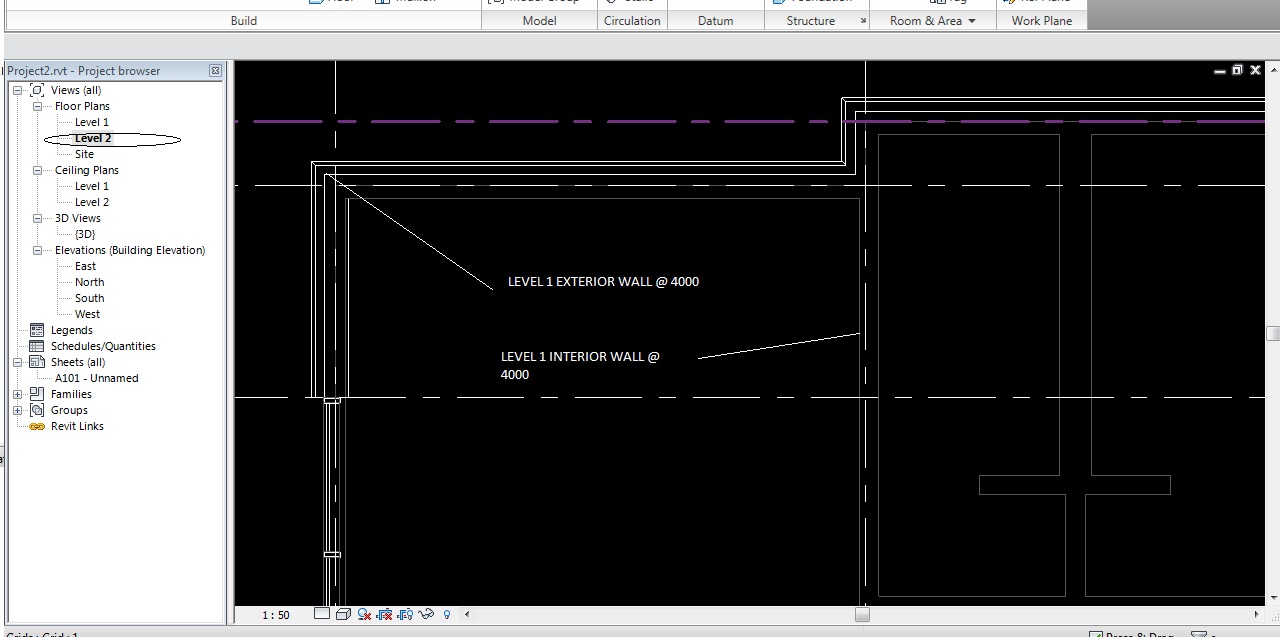

Hello to you all, this is my first post  here. I am working on a school project with revit and running into some trouble, but I am having problem with the level display. My Level 1 exterior wall is showing on my level 2. But my interior walls show up fine as a grey lines. I and pretty sure that they are both set to the correct height. Any help and suggestion is very much apprecieated.

ya I check already, I dont think the view range is the problem, but I try again by creating a new wall. It shows up as grey line on a differerent level but when I added sweep, it messes up.

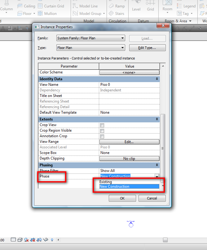

Those "gray lines".... Are you working with "Phases"?

nevermind, I got it fugure out, it turns out that my precast for the sweep is 1 mm thicker than the instructor have told us.
