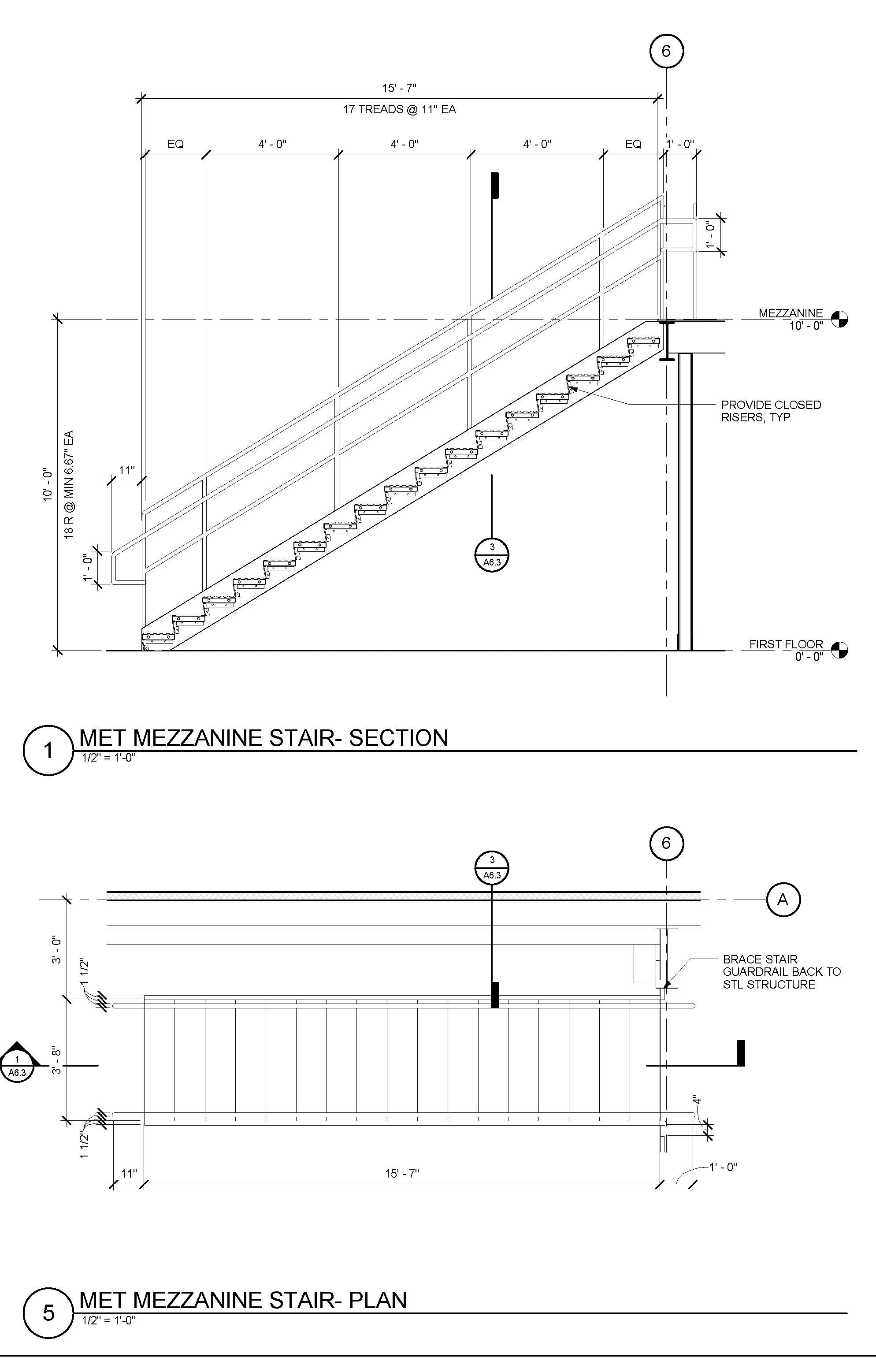

Trying to build this stair w/ handrail extensions etc.  Has a 42" guardrail with a 36" handrail that returns a little differently than most for saftey reasons beyond the code requirements.  Do I need to actually build two seperate handrails for this stair?
Sun, Apr 4, 2010 at 8:51:51 AM | Stairs w/ Guardrail to Code
Yes, you do need two different railings.  Do the ones hosted with the satirs, then the landing seperately.
