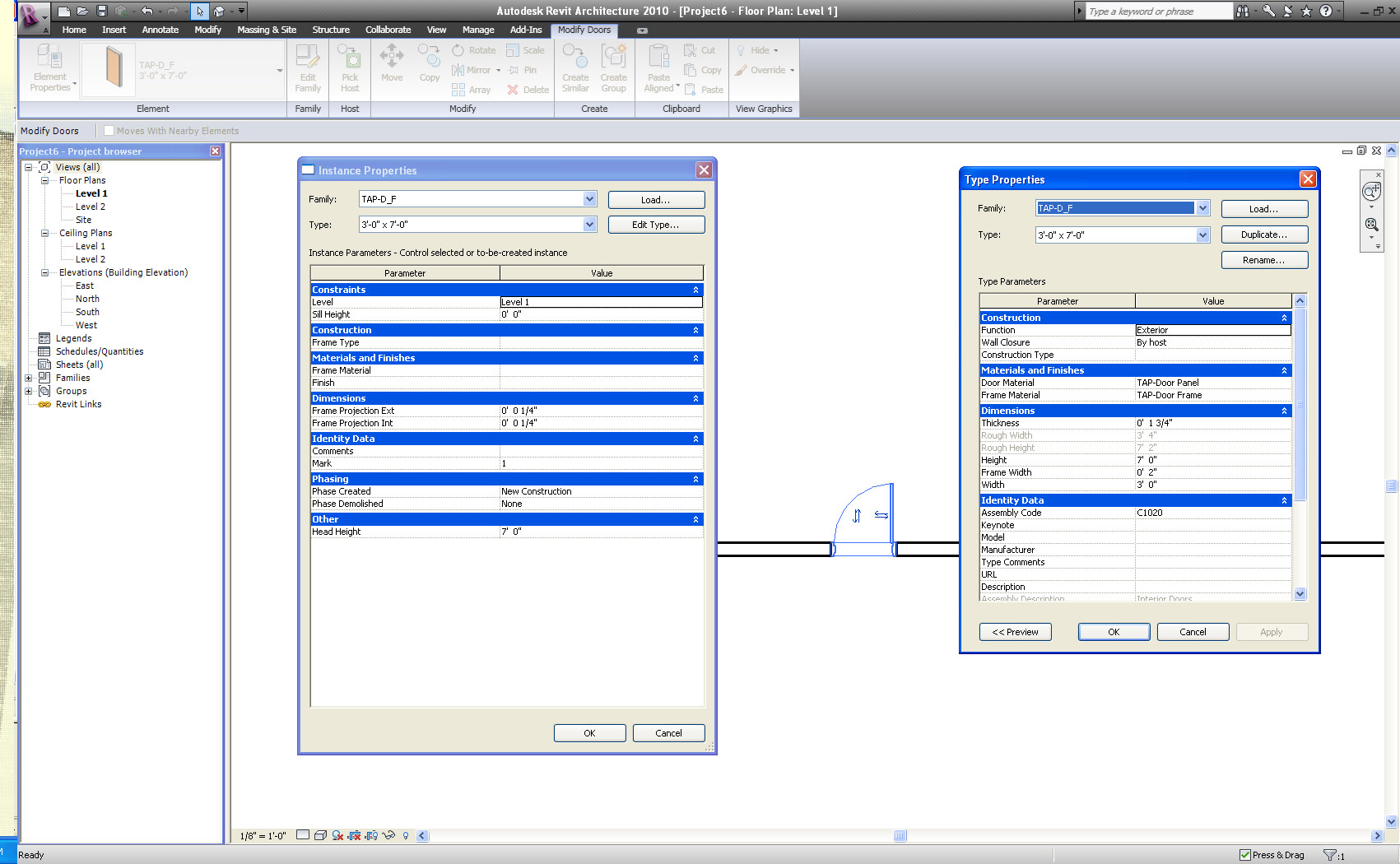

Hi, wanted to know if anyone knows.... I created a door family from the template that comes with revit 2010. I added 3 parameters 2 of them are instance and the other one is type. When I load the family into a project, when I select it and look at the instance properties, a whole bunch of parameter come up, that I haven't even created, like Head height, Frame Material, finish, Frame type....??? I want to get rid of these. anyone knows? appreciate any help
I added an image of what I get when I go on the properties....

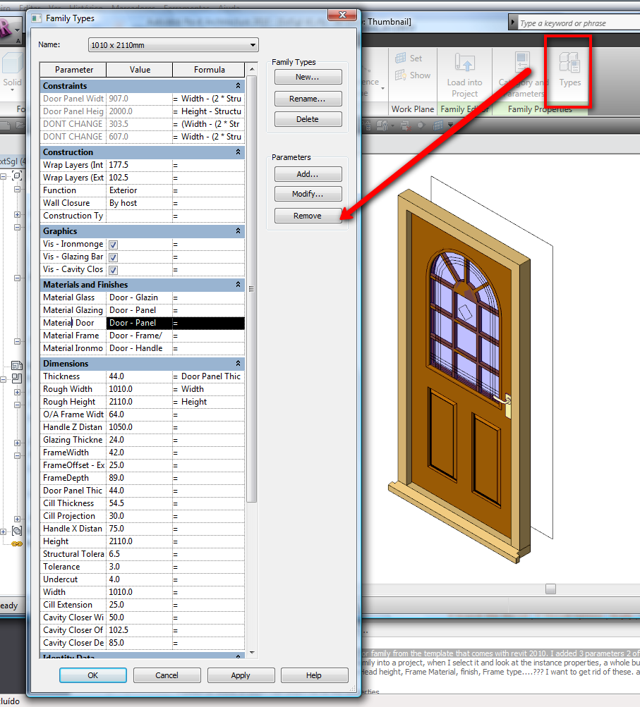

Those "Bunch" of parameters are in the door family by default, edit that family go to "Types" and you can "Remove" what you DON'T need...
