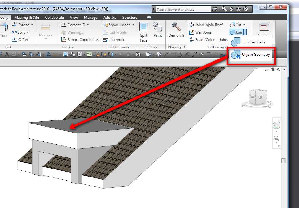

Yes, first use the "UNJOIN GEOMETRY" and pick in the Dormer roof then do the rest:
-Reset wall profiles
-Attached base of walls to roof
-Join roofs
-Create dormer opening by selecting exactly the same lines you showed

Thanks Typhoon!
That did the trick. A million times thanks!!!
