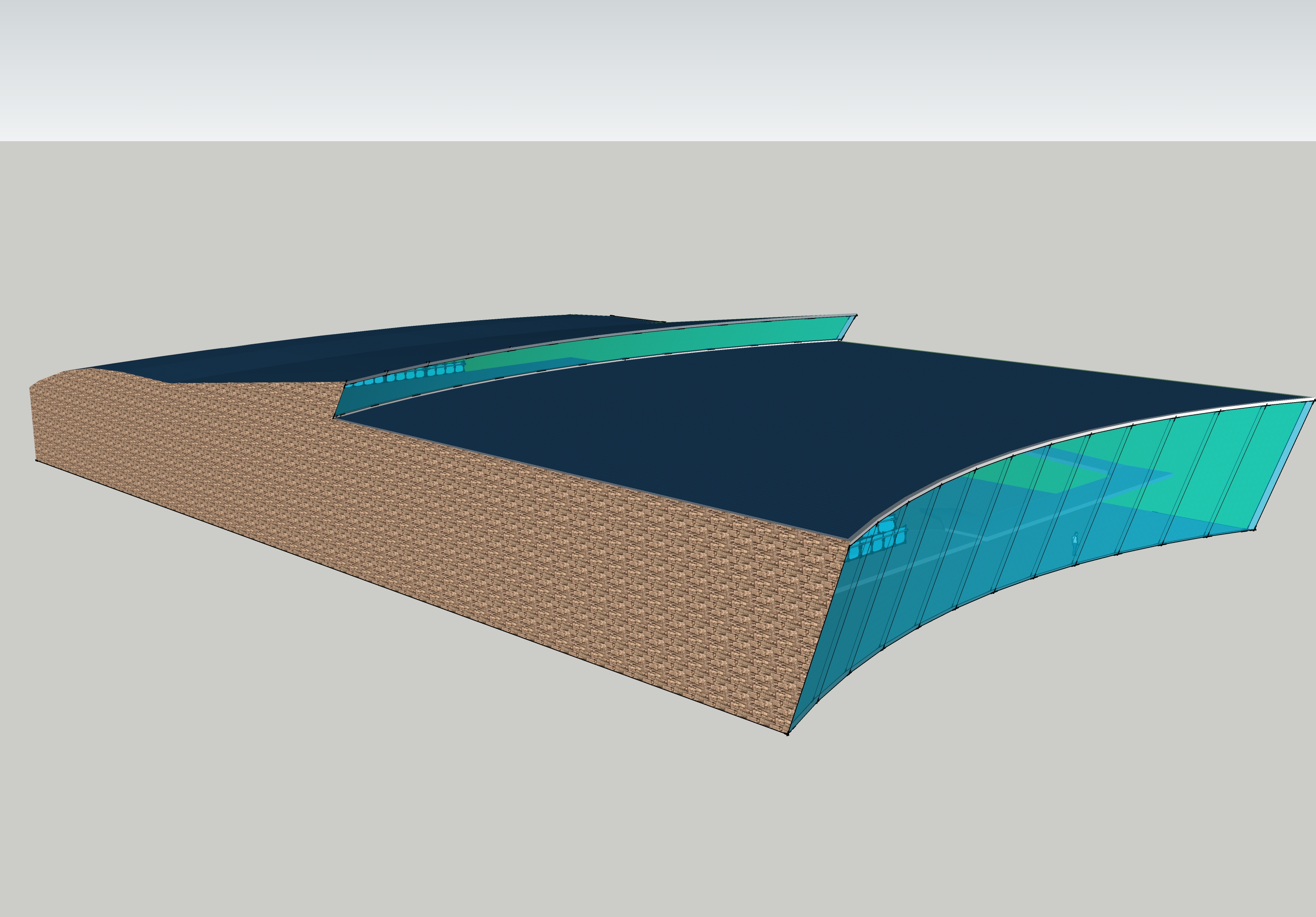

i am designing a building that will have a curved AND slanted front to it. there will be no openings in it or any projections, it is literaly a glass wall, how can i achieve this effect? it curves in towards the interior and it slants from the bottom of the buliding - to further away from the building at the top and is then connected to the roof which will be flat.
I have designed a sketchup model of the building and attached a jpeg image of it to this thread to help in describing what i mean.
 any help on this will be greatly appriciated.

You can model this in place.

what do you mean? i can just import my sketchup design? its only an initial sketch, its not to scale and the dimensions are wrong. Its is for a university assignment so i have to make sure everything is right.
Tue, Mar 30, 2010 at 9:25:16 AM | Curved AND slanted glass wall
I mean model in place.  Category wall - material glass . an extrusion(s) that is a blend where you describe the geometry at the bottom and the top.  Use your HELP.  Also, how to do that will be found in the families guide.
To access the Revit Architecture Families Guide, click (Help) drop-down arrowFamilies Guide.

Ok, see the video: http://www.megaupload.com/?d=DNQXT0E3

Brilliant help! thanks guys, nice and simple
