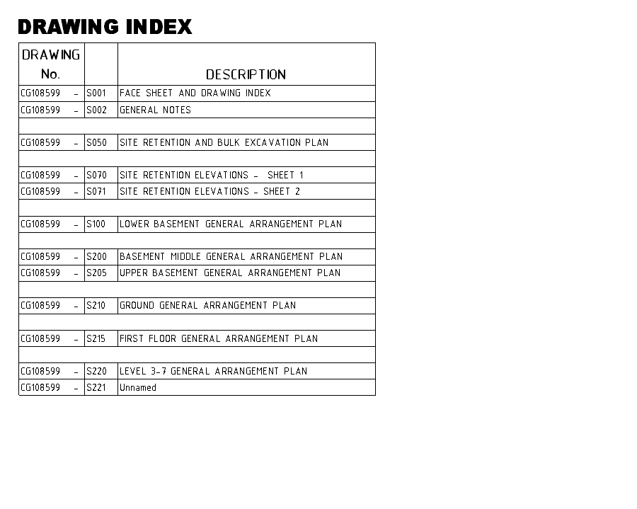

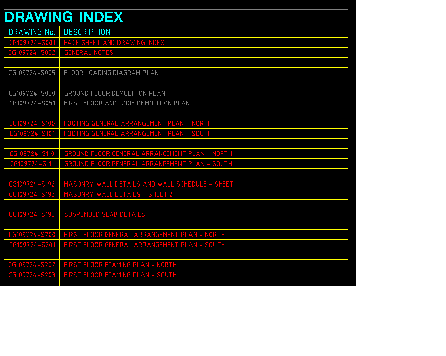

Im having trouble developing my drawing list. Im currently trying to match our office standard index, which is autocad based. Im trying to combinded my 'drawing no' and the 'sheet number' columns to achieve one column.
Ive attached two images to help. The white background is the revit one and the black background is what im trying to match. Also if anyone knows how to make the lines go all the way throgh the row spaces that would also help.
Thanks
Mon, Mar 29, 2010 at 5:11:52 PM | Drawing List Help - merging columns or making lines 'invisable'
You don't have that kind of control in revit.  Either adapt your standards or turn off the grid lines and add those manually.

Thanks for the reply.
How can i turn off the grid lines? can i do this so the text still stays on?
Thanks again
Wed, Mar 31, 2010 at 6:43:25 AM | Drawing List Help - merging columns or making lines 'invisable'
In your schedule setup - appearance.
