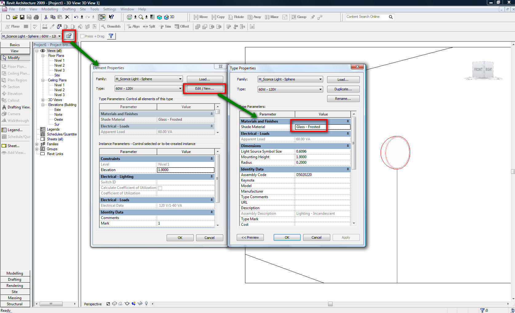

Hi I'm newbies to revit Please help me.
I'm load wall light from seek. and render It's light not appear in result.
I'm try to solve this and I found that fixture matterial is not glass, But How can i change fixture mat to glass
thank you very much

Go to Element Properties-->Edit/New...-->Materials & Finishes, and make sure if "Glass" is set with a translucent material......BTW, welcome here.......

thank you very much for your reply.
in sconce light sphere I'm can done like you said.
but in this http://seek.autodesk.com/product/latest/agg/visalighting/Visa-Lighting/18760
it's not have mat property.
can i kwon why?

apatiu, you can download your luminary here: http://www.revitcity.com/downloads.php?action=view&object_id=9068
Wed, Mar 31, 2010 at 1:06:13 AM | Wall light can't render problem
apatiu
Joined: Sun, Mar 28, 2010
3 Posts
amazing!! and thank you very much. erland73
