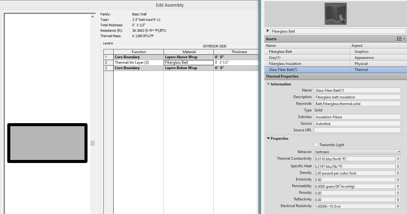

Well i just made a wall in revit assigned it batt insulation nothing else . . . gave it 3.5" thickness revit assigned it the R-value of 26.5683  Now to me that is 'STUPID"
I get that kenotes are useful (although i have observed them annoyingly change to question mark without warning) Their methoid is arcane and requires a whole bunch of setup.  Sometimes one can use a keynote and sometimes one cannot.  It is clumsy.
But when Revit fails to implement a simple thermal value correctly then i stand firm . . . it is not only stupid, it is "WRONG".
I should love to be enlightened by your superior knowledge mate and i probably have not done sometnhing correctly (an occurrance in revit about which i am intimately and sadly occasionally guilty) Just trying to make an energy compliance set on a residence and finding it disturbingly involved. Even the qs-Wall Quantities by Assembly schedule tells me that it's R- value is 26.5683 . . . sheesh.

Mahalo, yes i do find things disappear @ will from time to time i try to keep an eye on it . . . would love to know your thoughts on the weird R-value - try assigning thermal properties to a thing with just insulation and give it 3.5" and you might see what i see - or perhaps it is my 2013 version?
