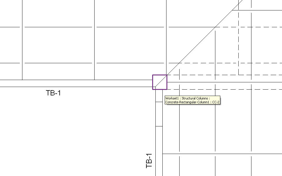

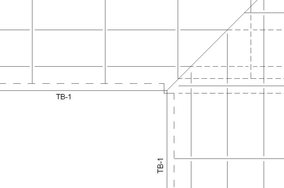

On my second floor I have a roof drawn but if I'm looking at the plan in wireframe I can see the columns below. When I change over to hidden (which is what I want to use) the columns go away. The columns are high enough that I should be cutting through them and I see the walls hidden below, so why would I not see the columns hidden below?

Something is hiding it ... like a roof maybe?

yeah, I have a roof turned on so that I can see my ridges and valleys. But why would I be able to see the walls below and not the columns below. They are structural columns not architectual.
Fri, Mar 26, 2010 at 10:39:49 AM | hidden columns
In VG - set your roof to transparent and see if that gives you what you want.
Fri, Mar 26, 2010 at 10:53:36 AM | hidden columns
patton
Joined: Fri, Jun 12, 2009
38 Posts
5 Stars: 2 Votes
SWEET! That worked great. I didn't even think about it being in there. That made total sense. Thanks
