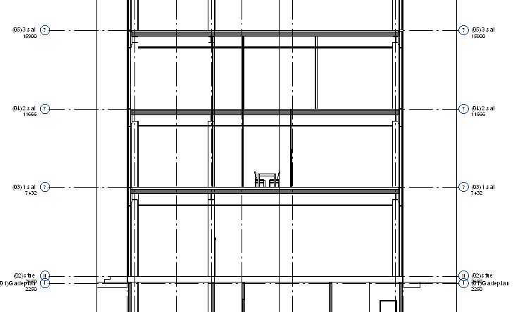

 I've got a weird situation here.
When i look at my section view, various components are missing; they are still in the model and appear in every other view but the section.
I've looked at vissibility parameters, hidden elements etc., and the really weird part is, that in this case it is a single column that's missing, but all the other columns are visible, also the ones that are placed at exactly the same grid as the missing one (view depth i was thinking)

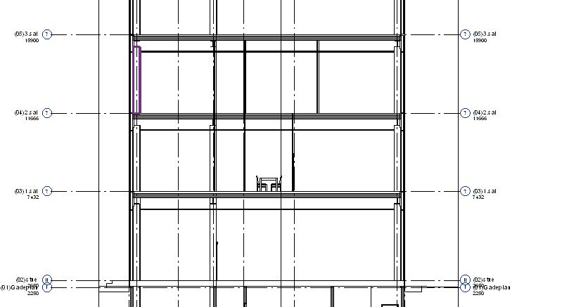

Now if I tab across the missing column it appears, but I can't get it to show in the view, I've even tried to change the family type and so on, but it doesn't show....
Ive attached a few snapshots that might explain the situation better, I've never had a problem like this before, so hope some of u guys out there might have the cure.
(Tried the old-fashioned delete-and-rebuild too, but still same problem, sometimes with different columns not showing)
 BR/
 JW

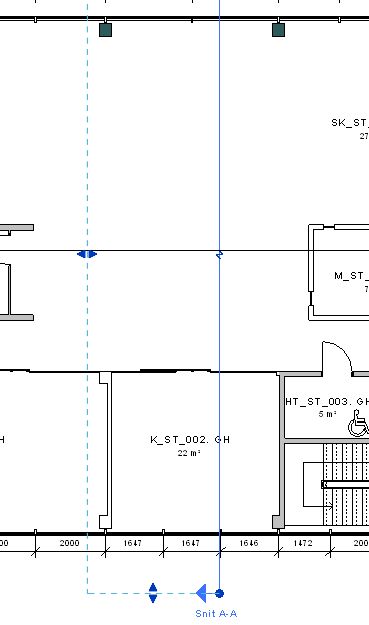

Right, i may have an idea but it's only a stab
 That room you are sectioning through K-ST_002.GH
 Your Wall appears to include the column within it's profile
If you added the column element into that wall, it would mean the wall would appear and you would not be able to see the column, but if you added the column inside of it you would be able to pick the element when you try and select it.
I would have your views to 'shading w edges' colour that wall bright red or something and see if it is simply in the way.
Other then that I have no clue sorry
