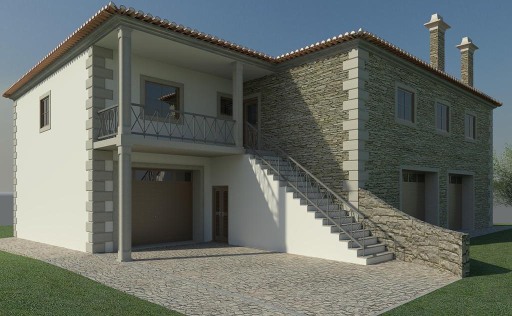

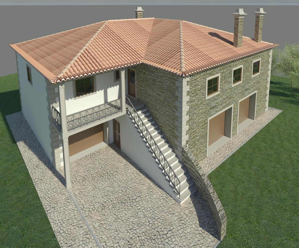

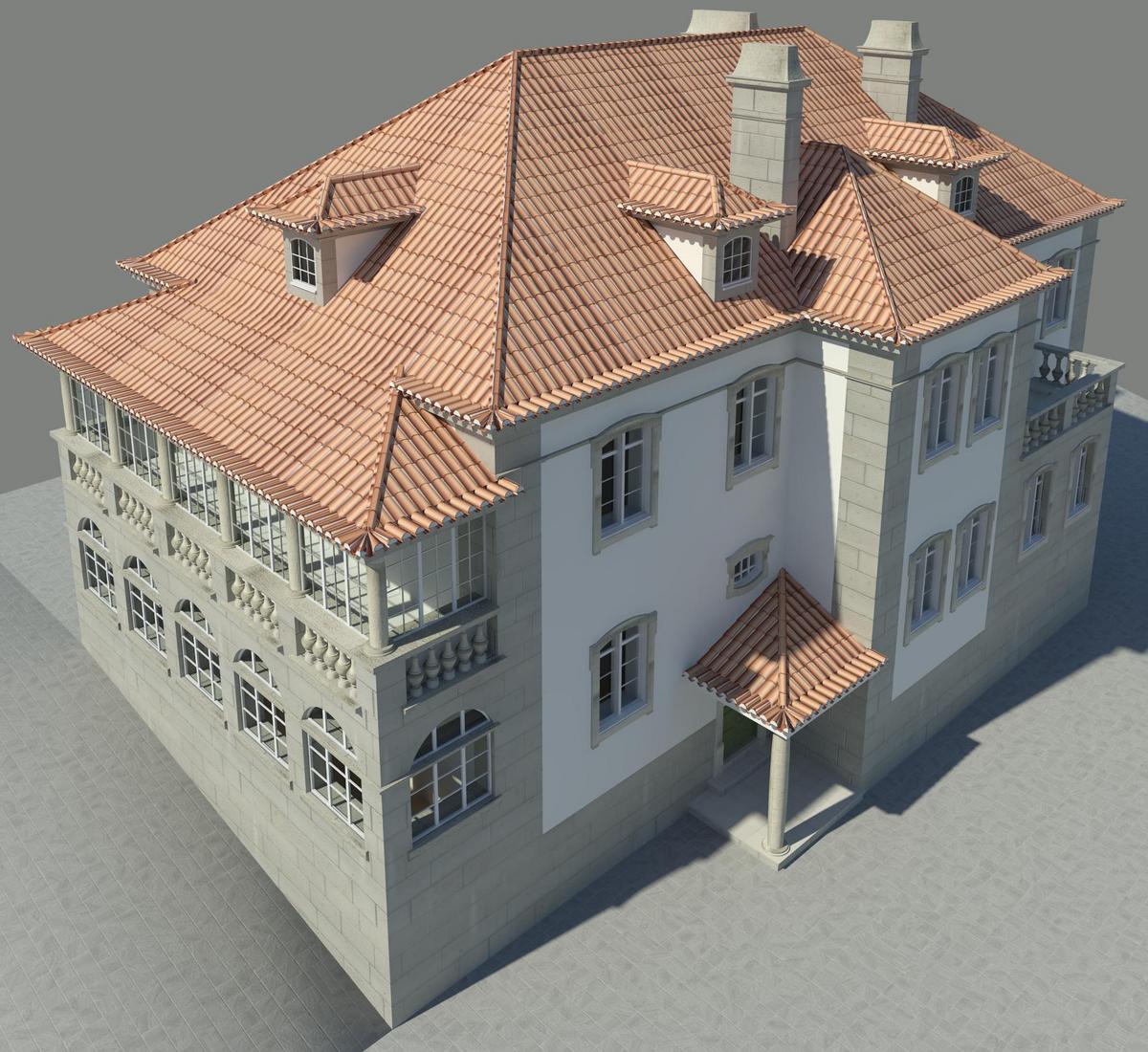

Like this?? use the right texture, see here: http://www.cgtextures.com/

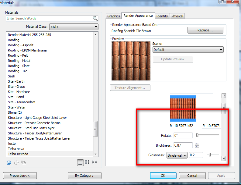

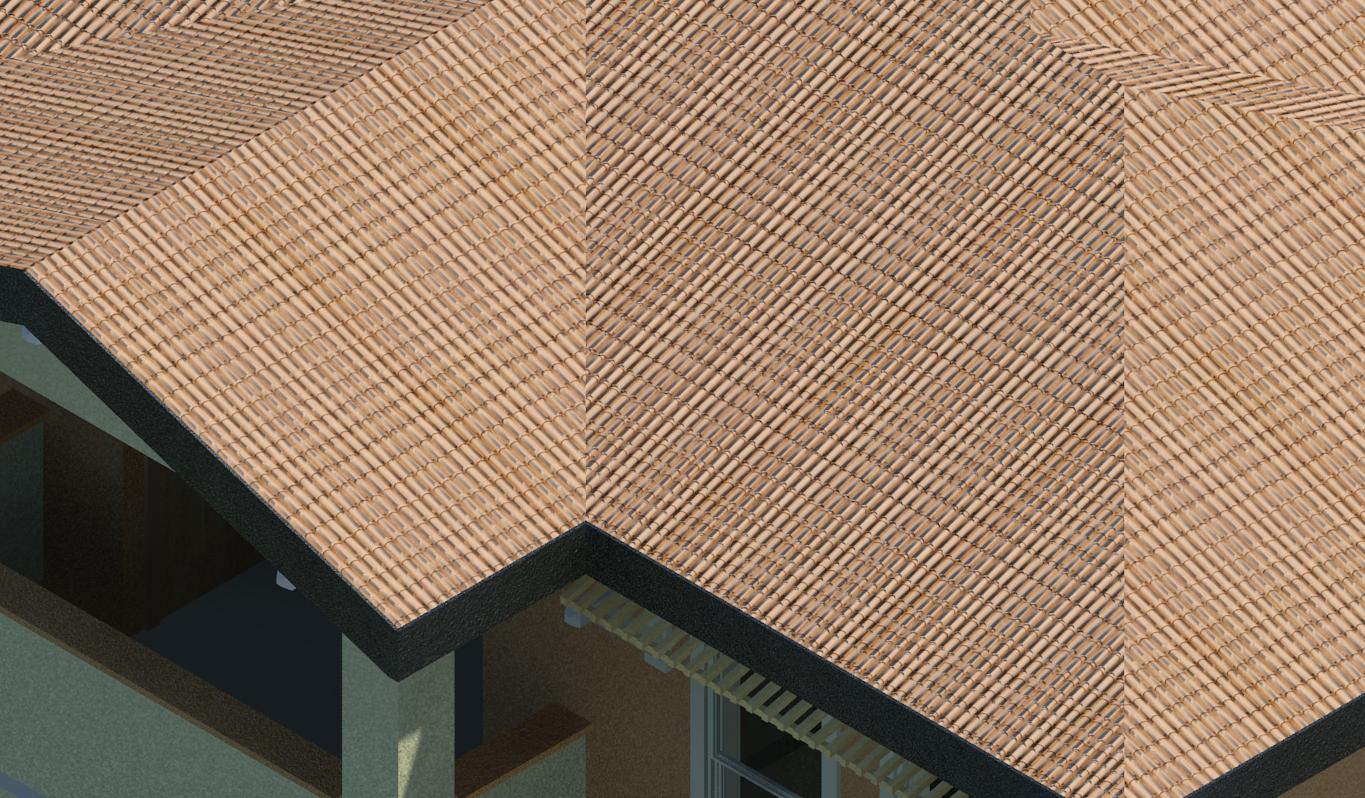

Here is how my roof looks, and also a screen shot of what my settings are.... just dont know what to do next.

Increase the lenght of the image in the material (4' to 10'), i don't work with Inches only metric system so is difficult to me to say the right lenght but i change the units so you can see....
AND increase the "Bump" too.....
