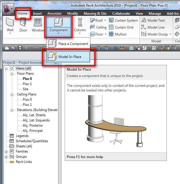

1. When I use Masing and Site / In-place mass /Create form, I can't find those five *blend, sweep...*.
   I can just see these five commands in Home / Build / Compnent....
   Isn't it strange?

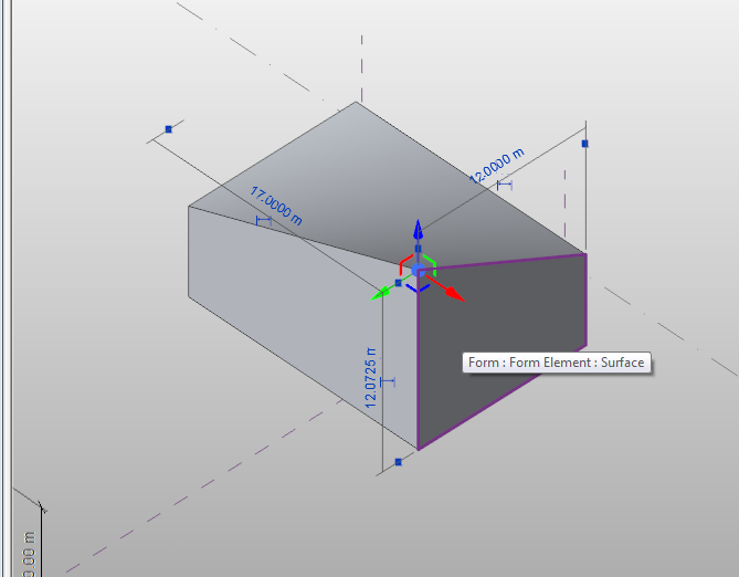

2. In massing and site, how can I edit any single point of an surface efter clicking *devide surface*? It seems I can just use *Add profile* to edit bigger part of the surface, not only a specific point.....

1º, see the firs image
2º, see the second image

Dear Typhoon
Thank you very much fo your reply.
1. So you mean there is no *blend, sweep....* under *Massing and Site*? What a pity......
2. For the second question, I didn't mean how to edit those 8 angles' points around the cube.
   What I would like to know was how to edit any random point on the surface to transform the cube to a *free form*
   model.
   Do you know any trick?
Than you......:-)

Dear Shenlunglinnk
My apologies for being so vague in my previous answer, of course you can use the "Extrusion, blend, revolve, sweep and swept blend", see the video: http://www.megaupload.com/?d=07E5RLSD

Dear Typhoon
AMAZIIIIIIIIIIIIIIIIING!
Now I get it.
Thank you very very much......:-)
