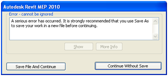

I then went back into the file, and went to investigate the families. When I open the families, I either received a “serious error warning”: (see attached)
Which closes the family.
