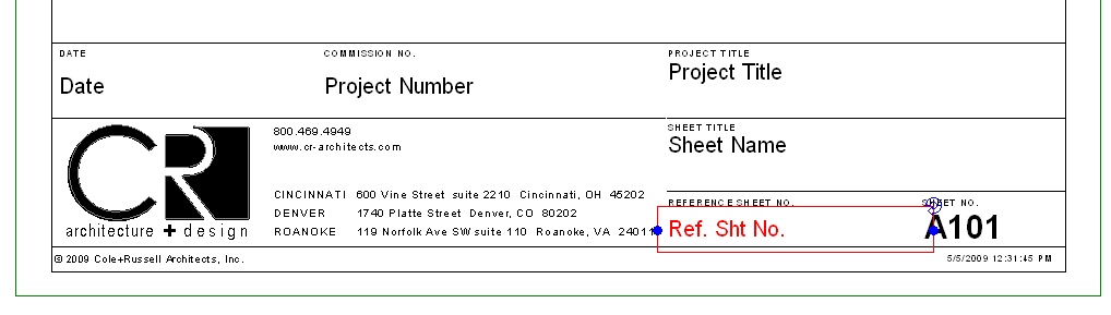

I am trying to add a shared parameter to our 8.5 x 11 titleblock for ASI's and want a label that can be edited as an instance for the referenced sheet number.  I made a shared parameter for this since it wasnt in the list of available ones, but how do I make it editable per instance?  Right now i just get the ? in the field when the title block is inserted into the project.  Any help would be appreciated!

i think you need to load the shared parameter into the project (in addition to the sheet family) (maybe)

i have this same problem, and I need it editable per instance.
I got it to work but once I change it on one sheet it updates every where on all the sheets... what do I need to change??

Add that shared parameter to your project and template and set it there when you add it as an instance parameter.

could you please explain this a little more?
"set it there when you add it as an instance parameter"
