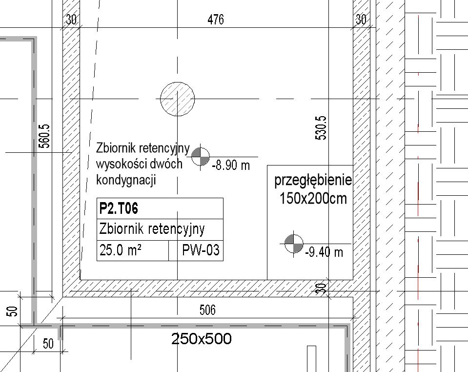

Spot elevations don't work on the top face of the linked slab, but they do find the edge of the slab...
That's not quite true. Please see attached screenshot were I was able to spot elevation on a linked revit model.
However after a while this feature stopped working in our file and right now I can't even spot the elevation on the edges of the linked file.
I am still looking for the solution.
Has anyone found a solution. Is there any setting driving the behaviour of the linked file?

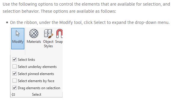

Tue, Aug 14, 2018 at 9:56:49 AM | Spot Elevation on linked file
#9
Look at the following image.

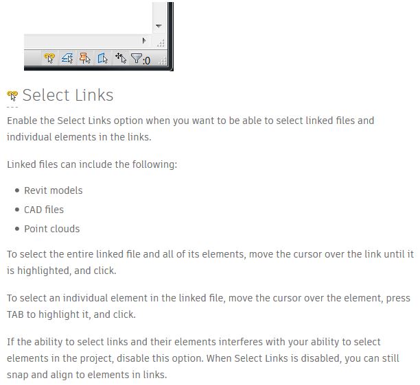

Tue, Aug 14, 2018 at 9:58:35 AM | Spot Elevation on linked file
#10
And this image.

It is not the case of enable the link on the selection tool. Already tried that.
Spot elevation tools works perfectly if I create a new floor plan of the same level. At the same time on the current drawing it is not working.
I just opened a case with Autodesk on this issue. Will post a solution if Autodesk resolves it.

The problem was related to Visibility/ graphics settings specifically Floors category ( Common edges, Hidden lines, Slab edges subcategories were unticked). At least it seems that it was the problem because the elements I was placing spot elevation tags was a structural foundation category so it is a bit ackward. These are tottaly different categories. Nonetheless all spot elevation tagsdescribing the linked model automatically appered again.
I can't confirm wheter it was really the problem or it is a software malfunction.
