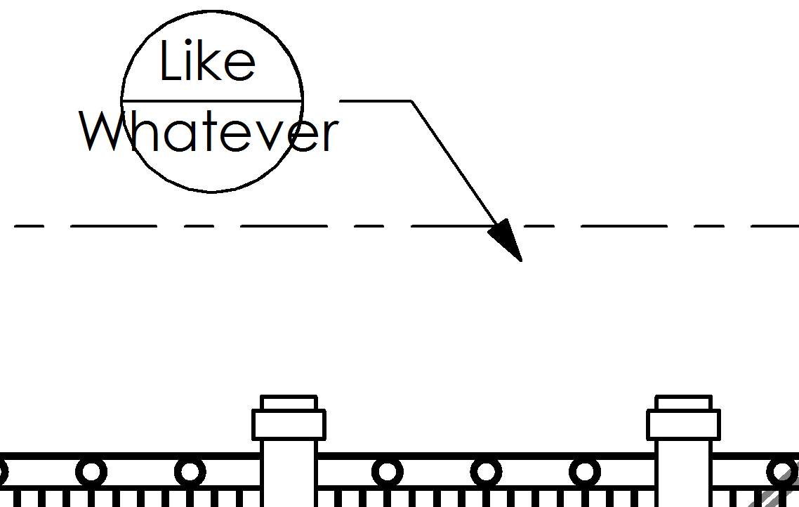

Here's a dummy callout head. Is that the intent?
(set up for A3 and A4 output)

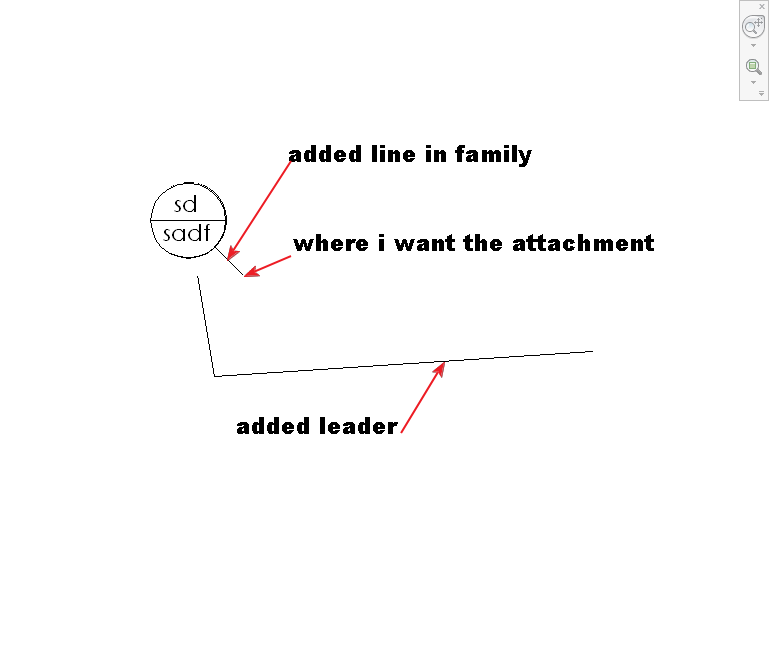

This is the intent but without needing to add a leader. The problem I am having with adding a leader is I cant get it to attach where I want (incramental 45).
