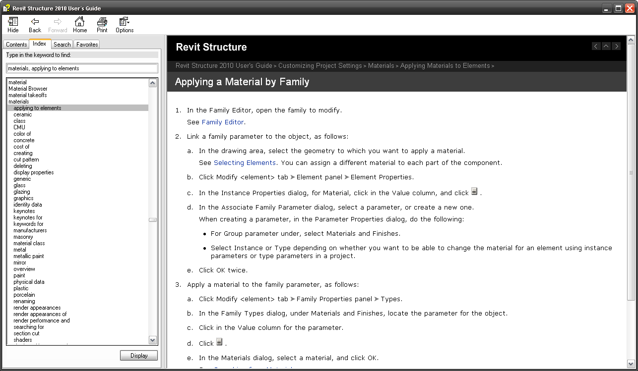

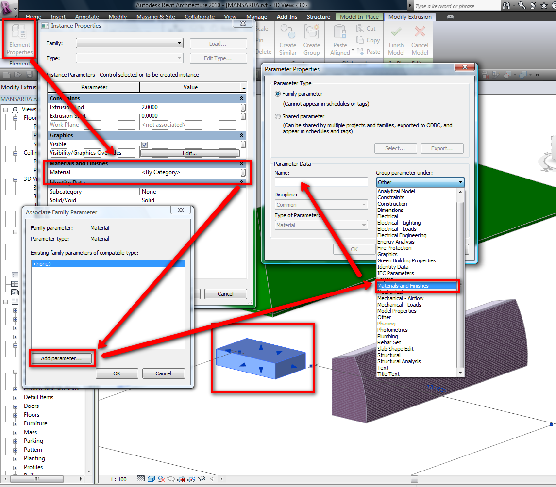

When you create a family how do you assign material to the extrusions?

Press F1

Just follow the arrows.....

"Press F1"
Thanks.
Wed, Mar 17, 2010 at 5:32:33 PM | Family
Oak3s
Joined: Tue, Sep 4, 2007
18 Posts
Typhoon - your image is very F1-ful. Thank you.
