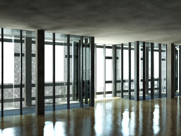

I am currently running a rendering on best quality and its made it to 50% in about 9 hours and now it has been at 63 percent for the past 7 hours.  I am pretty sure it is still rendering because as few more of the squares have finished.  Also the rendering is 8"x10" 150dpi set on Best.  I have attached a copy of a lower quality rendering so you can see what I am working with.
 My computer specs are as follows:
6GB Ram  Intel Xeon 2.33 Ghz Processore and a 512 MB 9600 GT Video Card with a 320 GB harddrive that is not even close to being full.
So, I don't think that is the problem.  I had the computer built by Xi Computers and it is cooled very well.
If you have any ideas why it might be taking so long please let me know.

Well, interior renders in Revit is a pain in the butt, and it's worse if you have many lights, reflections, curtain walls... I hope, in 2011 version, they correct/Improve this issue.

What people don't take into consideration for rendering are the materials.
Materials can kill a rendering as bad or worse than complex lighting.
The more complex the material the worse off Revit will be.
  • Bumb maps
  • High Gloss
  • Perforations or Cut-outs
All these things will really impact performance. Also, you have daylight portals which increase time significantly.
Other items to consider:
What is your opertating system? 64bit?
Is your PC using a dual processor?
What is your page file set to?
You could try setting the priority a little higher for Revit...BUT DO NOT SET IT TO REAL TIME!!!! It will lock your computer by assigning all resources to REvit...your mouse will not even work.
I would do this ONLY as a last resort....ONLY!
