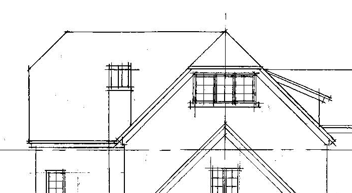

The attached sketch shows a gable with a clipped roof.  It's like a partial hip that is part of the shingle style vocab.  And ideas how i can model that?  I have the gables completed  but am unsure how to clip the ends off.  thanks in advance?

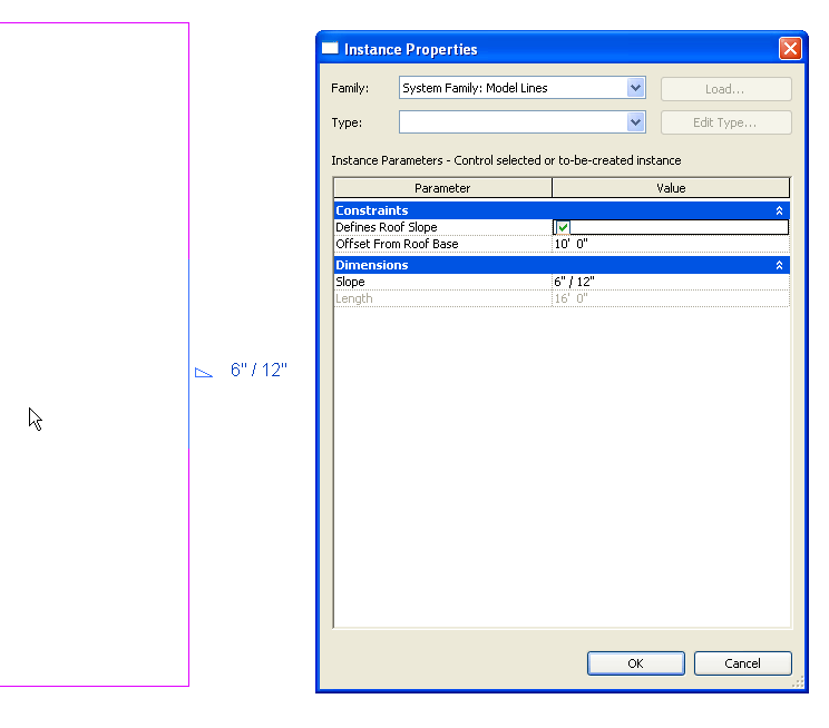

Do you mean like this?
Just split the end lines into 3 portions then set the middle to slope and set its offset from the remaining roof.

Thanks HUB for including the screen shot.  i was trying to include ridge lines and that was causing errors:/  my bad.  I also needed to give the midle line a base off set.  that was EZ.
THANK YOU!!!!!!!
