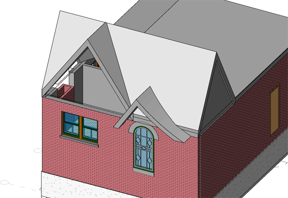

Does anyone have any advice for how I would go about modeling this condition?  The brick in this image should attach to the top of the dormer and the dormer should cut and join the main roof.    I've been trying join roof, but the dormer won't cut the main roof.  Can't seem to get dormer opening to work either and I'm not sure how to do it with modeling - create roof.  Been driving myself crazy, if anyone has some advice I would greatly appreciate it.

I assume you are using the attach wall command to attach the wall to the roof. Make sure the dormer roof is completely over the wall.

Yeah, using the attach wall command.  If I extend the dormer in to cover the wall, then it won't join/cut the main roof and it's a completely different problem.  I need the wall/dormer/main roof to come together at that point.

Then use the edit profile tool.
