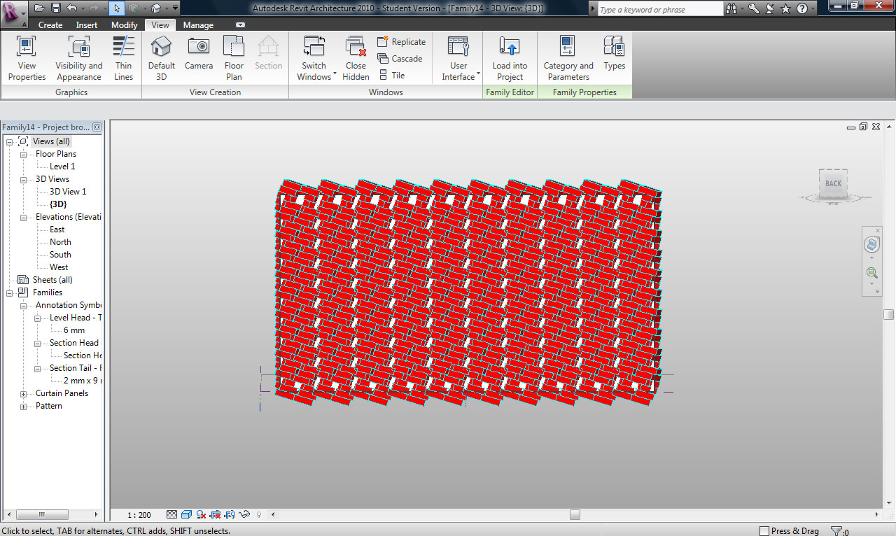

I am trying to allow a curtain wall panel to overlap but it is not allowing it and constantly pressing itself within the boundaries.
Is there anyway to change this so it is not constrained.
The photo belows shows the brickwork desired followed by what happened when placed into panels.
 http://www.brick.org.uk/_media/_images/_awards//__standard/10311BW_SAHRC.jpg

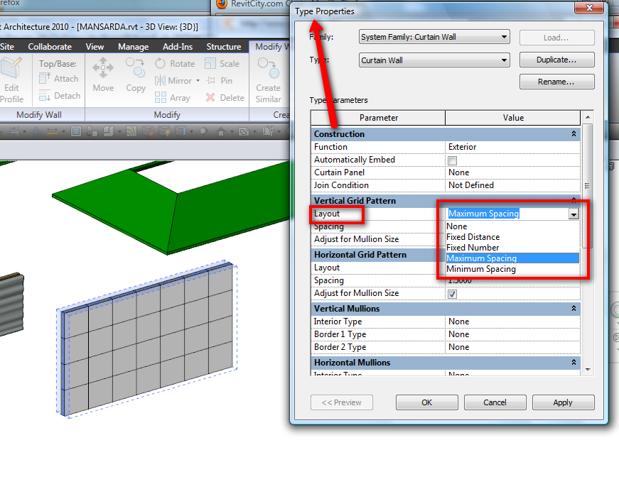

I don't know how did you create that curtain panel but did you try to change the "Layout" of that curtain wall and check if that solve the problem?

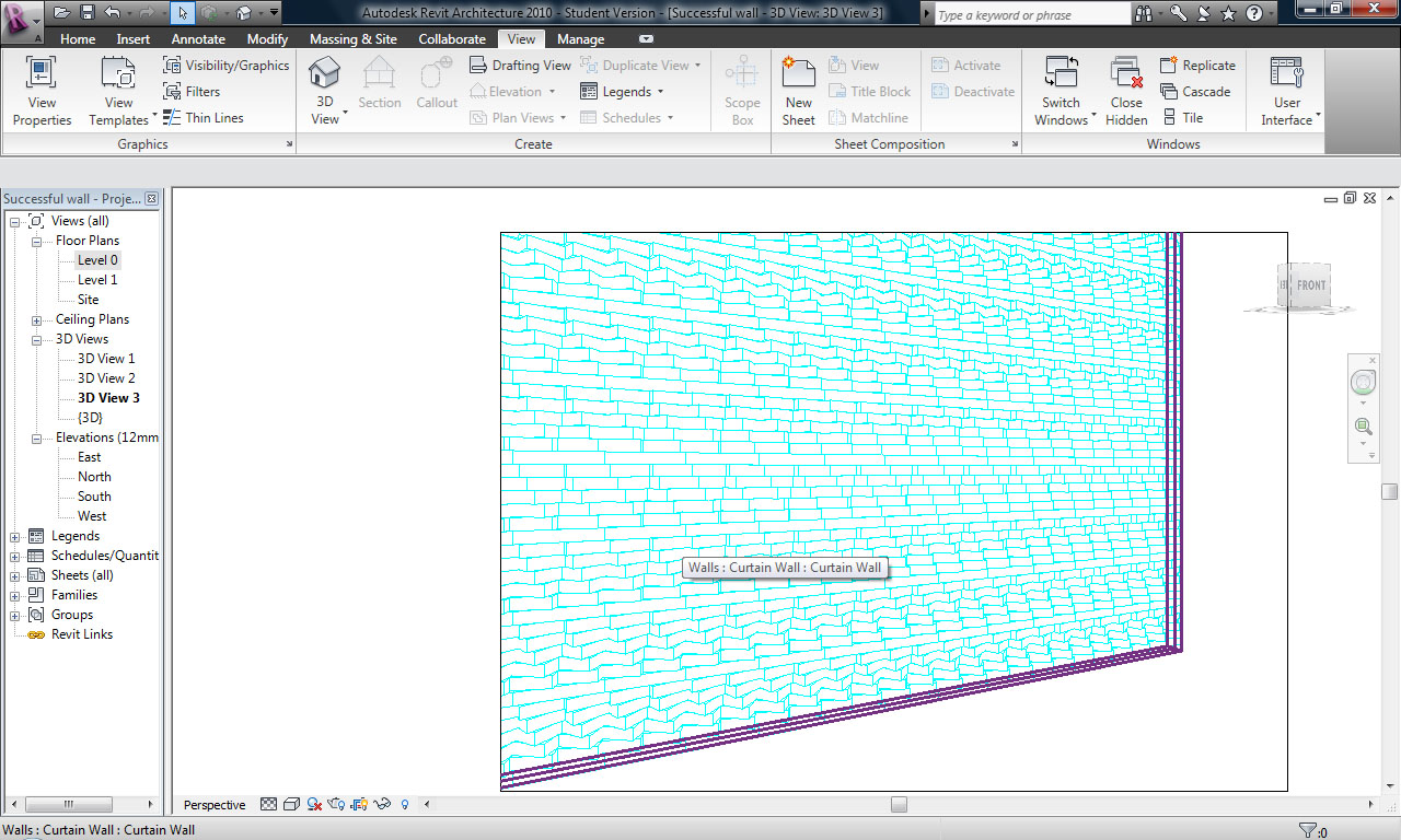

Hey did a few adjustments myself and tried fiddling around with those the type settings and it worked.
 I am now trying to find out a way to punch holes in it for the windows as this is actually the facade. I have tried editing profile but it ends up making the panels very patchy. I will try again tomorrow.
 Maybe face based panels would work with voids? I have yet to try it. But if you could suggest anything else then that would greatly appreciated. Smile
