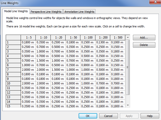

Hi, is there anyone knows how to draw the line which is less than 0.8mm in Revit? And how to combine a arc and line into one polyline?Thanks

Edit the line weights.
Not sure there is a polyline. Select a line and tab and all the connected lines will be connected.

There is no polyline in revit but lines can be drawn in sequence and as such are selectable with one pick.... use your tab key.
If you are asking about line width then mcantwell gave you an answer but I believe you were asking about line length.  Revit will not deal with very short lines like CAD does.  This allows Revit to be faster... and after all, why would we be dealing with very-very short lines in buildings?  We don't work to those kind of tolerances.
