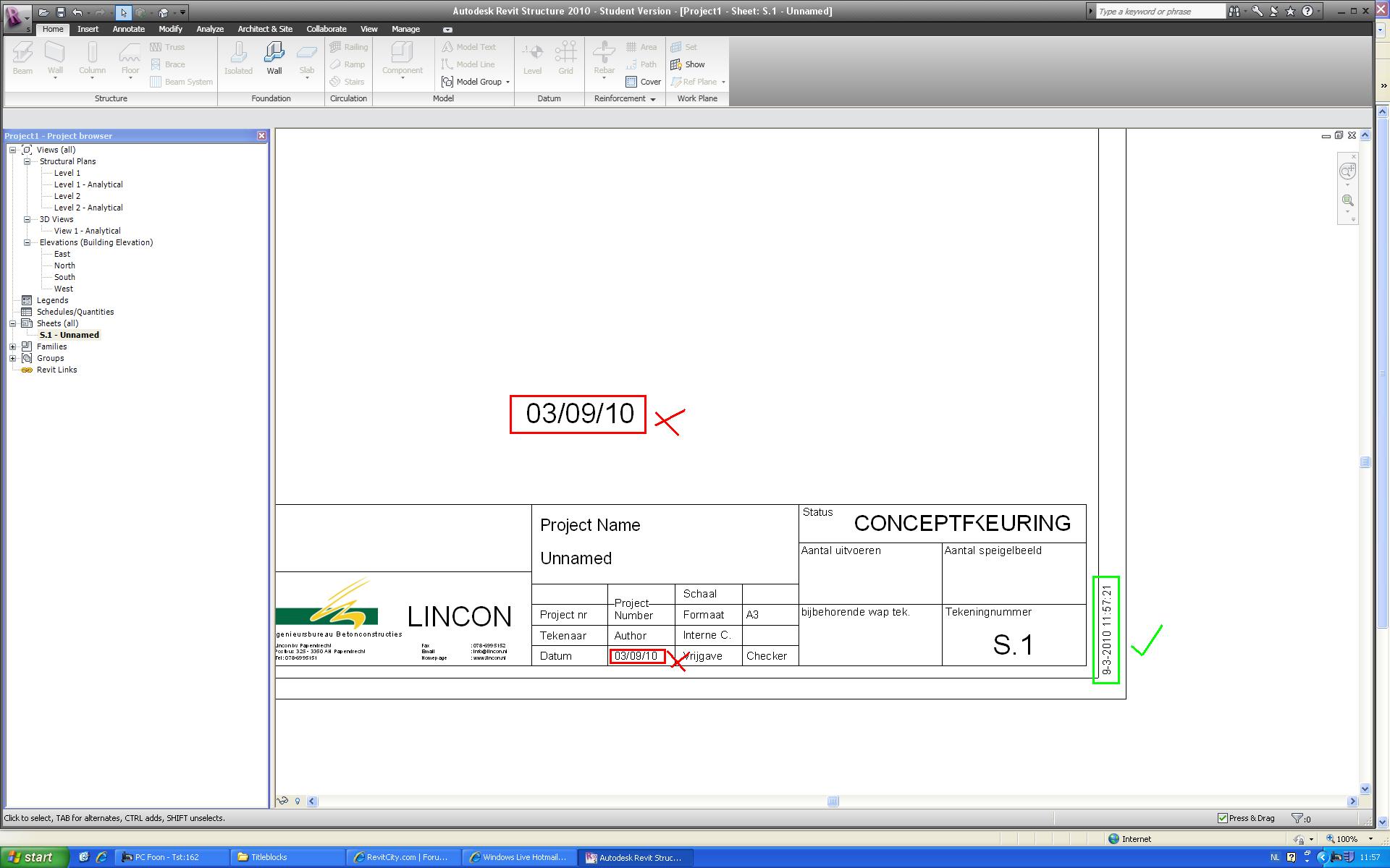

I made a new sheet layout and everythings works fine exept the Sheet Issue date.
I want 09-03-2010 and revit keeps writing it as 03/09/2010. I tried everything.

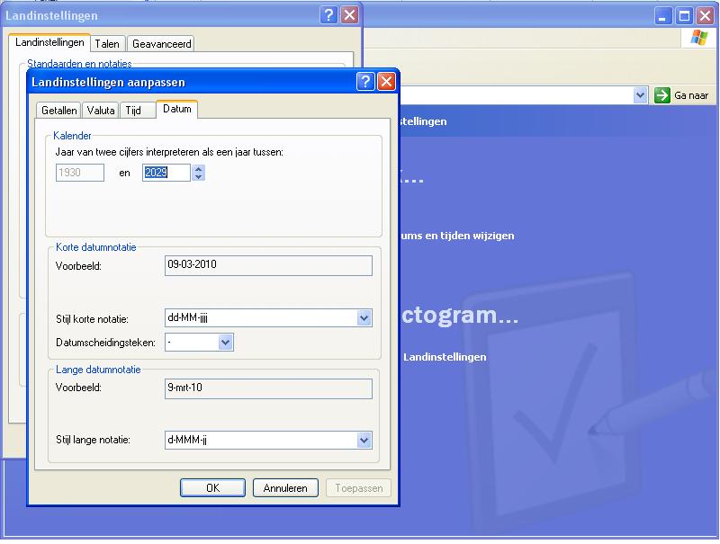

I modified the windows default time and date layout and there it displays as dd-MM-jjjj, so thats fine. Date-Time stamp works perfect and shows it like 09-03-2010.
Windows XP is Dutch by default.
Could use some help here.

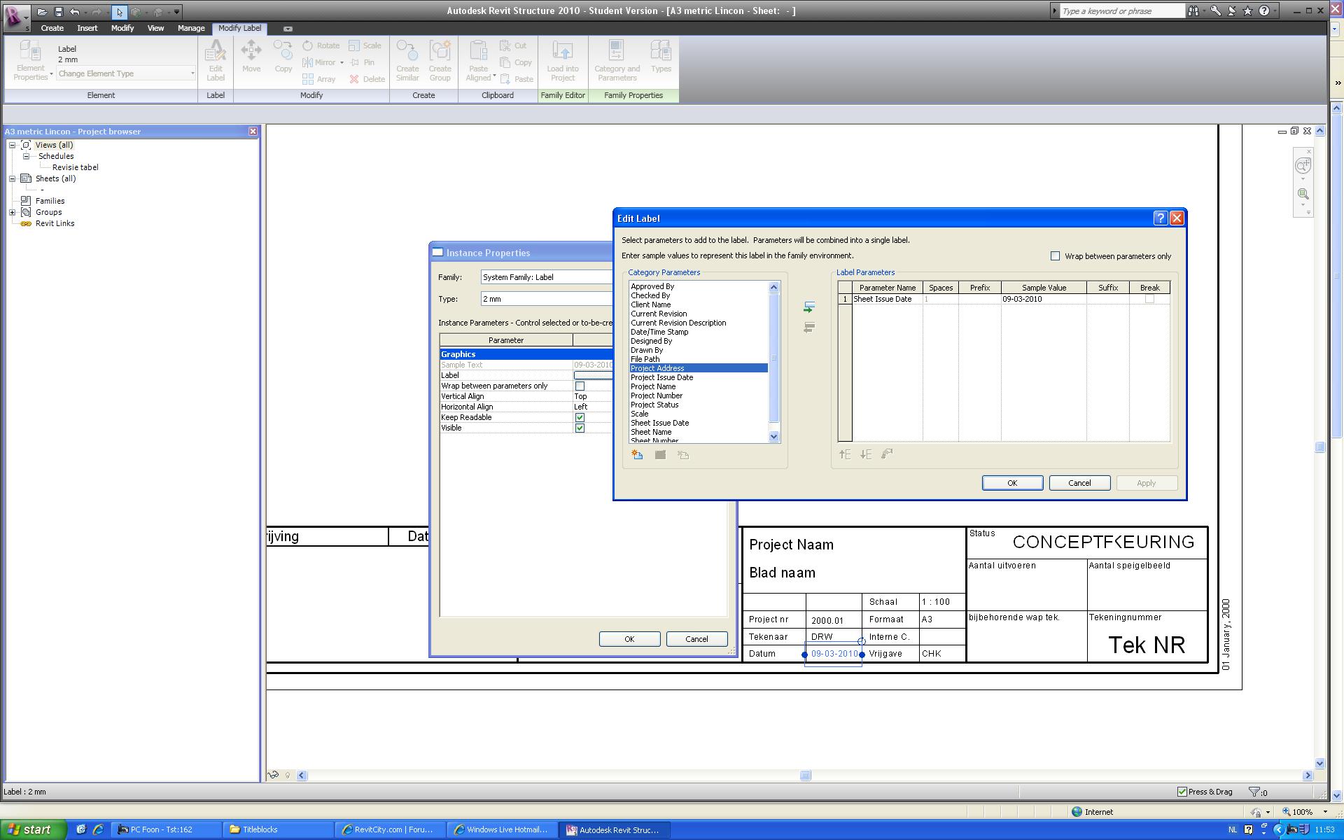

sheet issue date is a parameter you have to fill in yourself @ your project, project information,
if you want to have the exact time of printing everytime, use the Date/Time stamp label.
