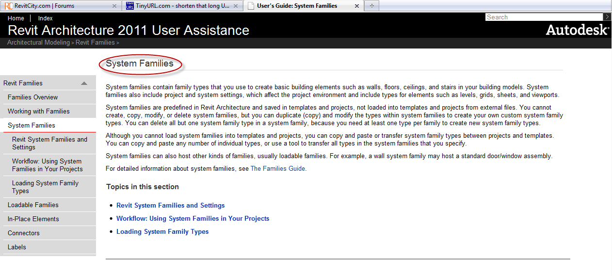

Good Question? I trying to help let me invetigate more. but its an excellent question. oops System family can not be edit or modify. so I guess we will have to wait autodesk to make this thinkwork ramps volume and all solids volume. see the image attached for more info...
