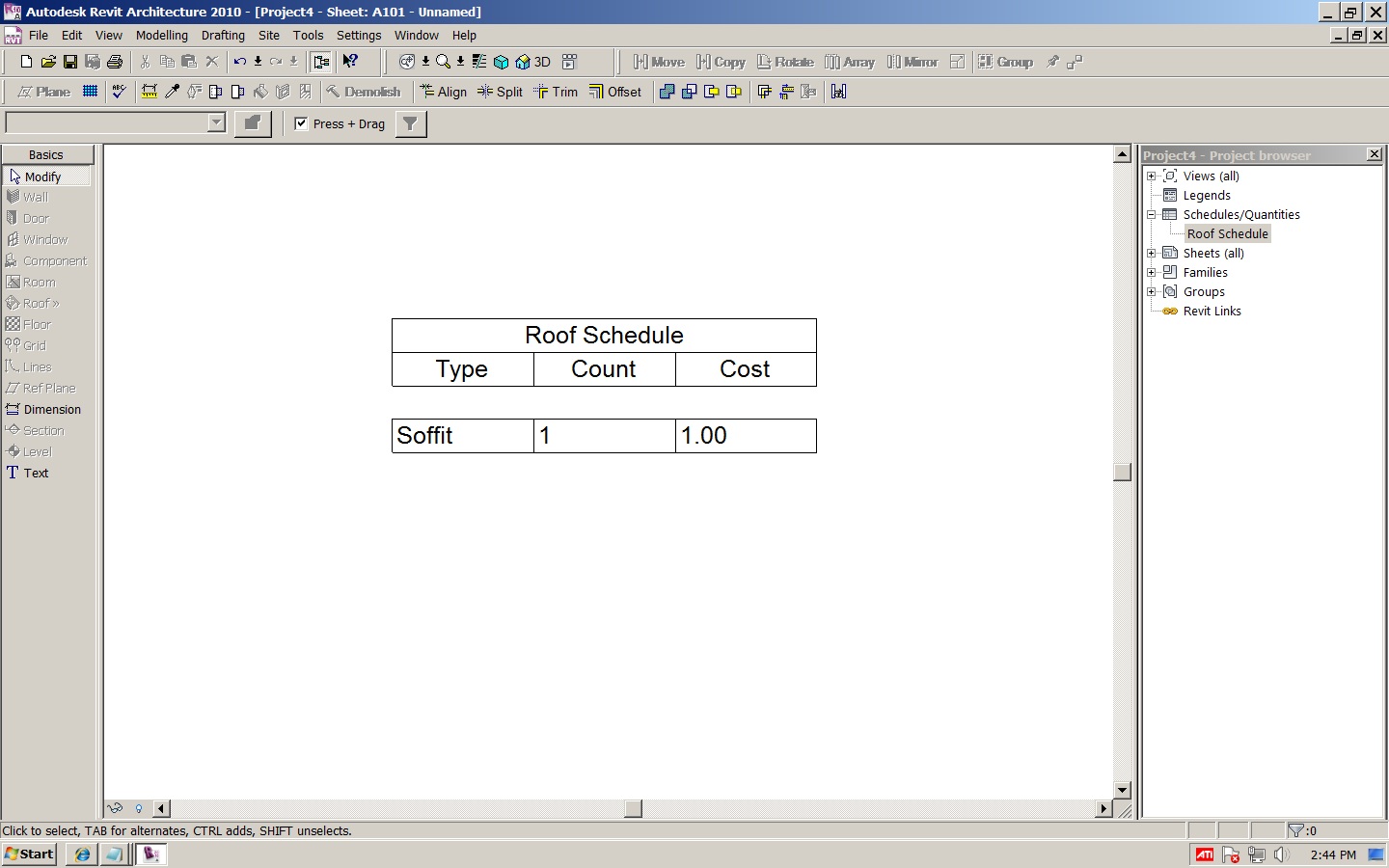

i was just thinking to schedule soffits under roofs
only because autodesk said a soffit is a roof object..
but take a look at my roof schedule and see what
you think about it and let me know..

Hub-
if i did schedule the soffit this way- how can i add
other roof object into this same schedule?
